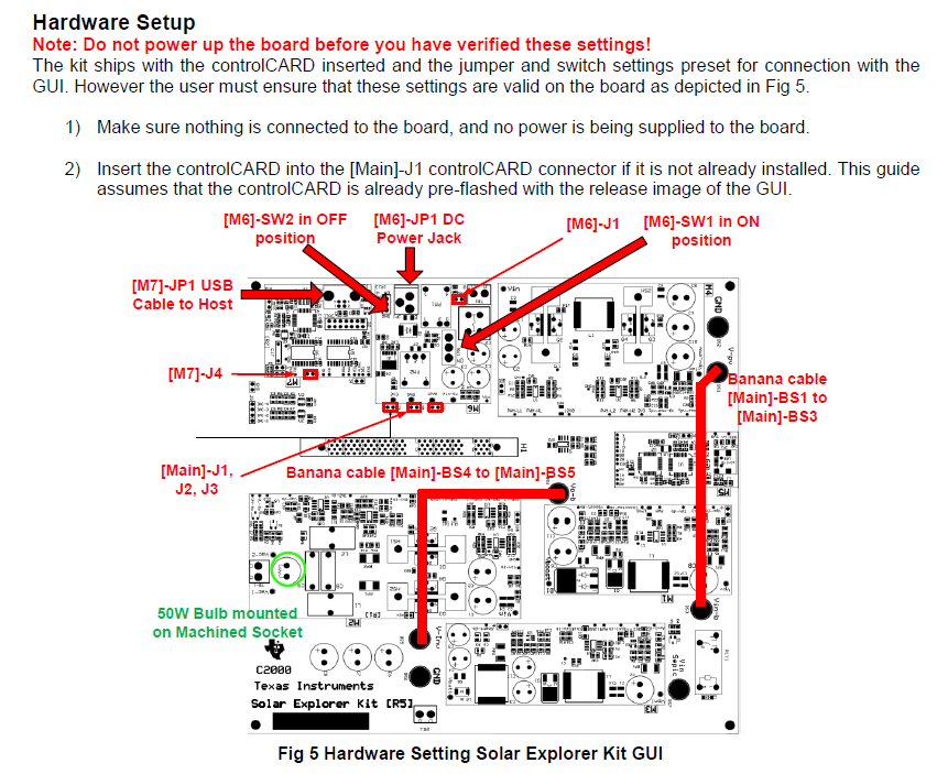

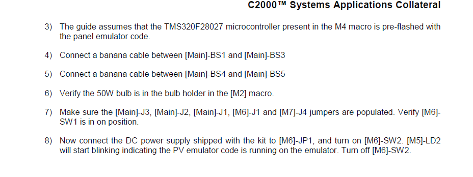

Im working on the TI Solar explorer kit and im currently working on the following lab code provided with the kit in control suite. The Implementing Photovoltaic Inverter System using C2000 Microcontrollers on Solar Explorer Kit, v1.0 1/31/2012 ( i was wondering if there is an updated version of this document as well.

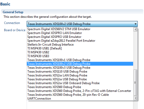

Well where im having issues is on the: 3 Hardware Platform Setup , specifically the 3.2 Software Setup portion of the document/lab. on part 6. where it asks to select the connection type: Connection – Texas Instruments XDS100v1 USB Emulator but that is not one of the options.

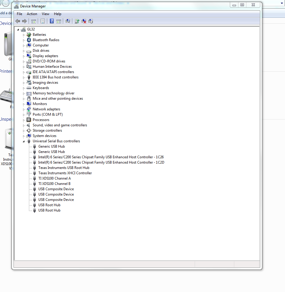

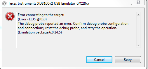

The closes option I have to that is Texas Instruments XDS100v1 USB Debug Probe and when I run the code, it builds fine, have not issues there but when I run and debug it I get an error. I think its that it can't connect to it or something similar to it.
