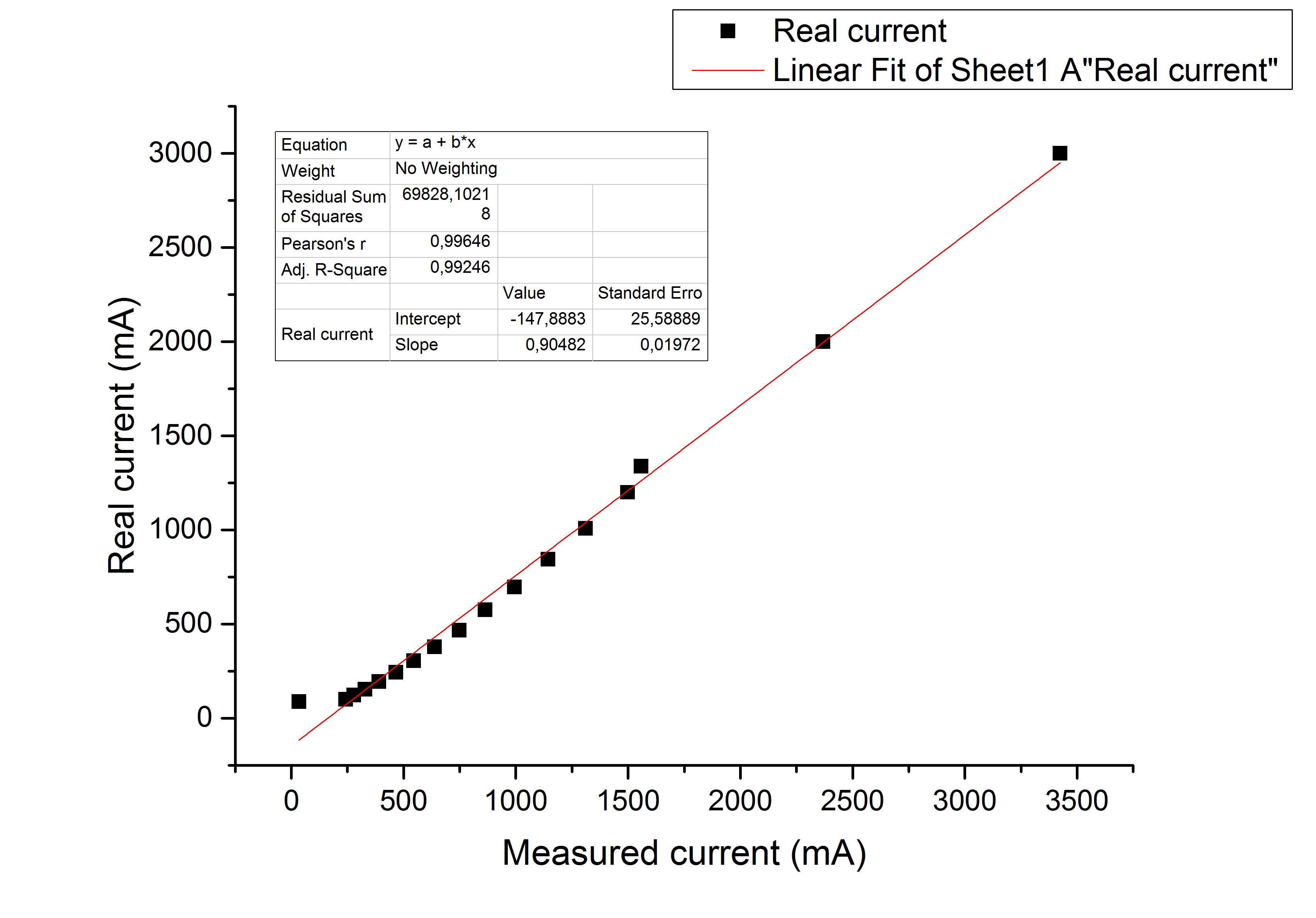

I tried this and a bunch of other formulas for this calculation that I found online, and none of them seemed to give a proper result. My final solution was essentially something like this (not actual code):
temp = sqrt(Iq*Iq + Id*Id) temp_f = _IQtoF(temp) I = a + b*(temp_f * 1000) //I in mA.
The result of this calculation is very unstable, so I calculated an average over the last 512 points, to make the result acceptably stable.
The a and b were then determined experimentally (and because of the limitations of how I could measure the current, included the power consumption of the board). In case anyone is wondering, my particular values are:
a = -147.88839
b = 0.90482
This was my data set for determining a and b (all but the last 2 points were set by increasing rpm, the last 2 by restricting motor movement). "Real current" is the one measured by an external device and "measured current" is the one calculated with the board before applying the linear correction:
I hope this helps someone. Cheers.
