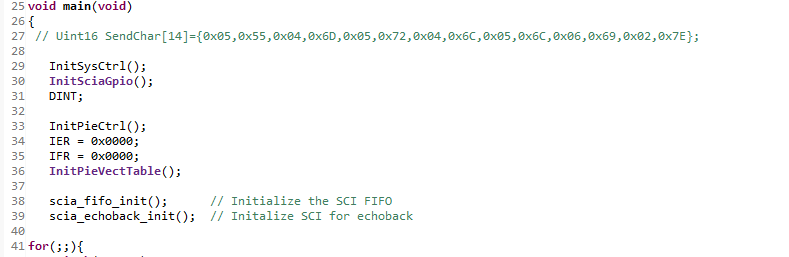

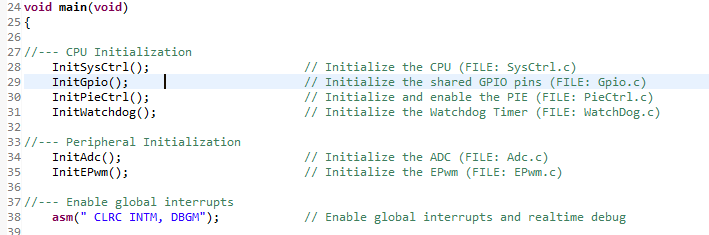

we have two code like in figure one for sci and other for adc
how can initialize different module available in C2000 Family ???
CODE FOR SCI
CODE FOR ADC
  • Here, if we initialize ADC at start then that will affect SCI or not ??
    How can we define ADC code initialize this in between the SCI code ?
    After Using ADC code we have to again get into normal internalization, can we do that?
    You can initialize both the peripherals in a single code in either way - sci first and then adc or vice versa.
    Did you try the same?

  • Yes sir,
    Here main question is which things we are initialize for ADC ,we have to stop that after using ADC module,
    we mixed and build with on error , now we have to try it is working or not...

  • Follow this structure:
    main()
    // Step 1. Initialize System Control:
    // PLL, WatchDog, enable Peripheral Clocks
    // This example function is found in the DSP2803x_SysCtrl.c file.
       InitSysCtrl();
       InitSciaGpio();
    // Step 2. Initialize GPIO:
    // This example function is found in the DSP2802x_Gpio.c file and
    // illustrates how to set the GPIO to it's default state.
    // InitGpio();  // Skipped for this example
    // Step 3. Clear all interrupts and initialize PIE vector table:
    // Disable CPU interrupts
       DINT;
    // Initialize the PIE control registers to their default state.
    // The default state is all PIE interrupts disabled and flags
    // are cleared.
    // This function is found in the DSP2802x_PieCtrl.c file.
       InitPieCtrl();
    // Disable CPU interrupts and clear all CPU interrupt flags:
       IER = 0x0000;
       IFR = 0x0000;
    // Initialize the PIE vector table with pointers to the shell Interrupt
    // Service Routines (ISR).
    // This will populate the entire table, even if the interrupt
    // is not used in this example.  This is useful for debug purposes.
    // The shell ISR routines are found in DSP2802x_DefaultIsr.c.
    // This function is found in DSP2802x_PieVect.c.
       InitPieVectTable();
    // Interrupts that are used in this example are re-mapped to
    // ISR functions found within this file.
       EALLOW;  // This is needed to write to EALLOW protected register
       PieVectTable.ADCINT1 = &adc_isr;
       EDIS;    // This is needed to disable write to EALLOW protected registers
    // Step 4. Initialize all the Device Peripherals:
    // This function is found in DSP2802x_InitPeripherals.c
    // InitPeripherals(); // Not required for this example
       InitAdc();  // For this example, init the ADC
    // Step 5. User specific code, enable interrupts:
    // Enable ADCINT1 in PIE
       PieCtrlRegs.PIEIER1.bit.INTx1 = 1;	// Enable INT 1.1 in the PIE
       IER |= M_INT1; 						// Enable CPU Interrupt 1
       EINT;          						// Enable Global interrupt INTM
       ERTM;          						// Enable Global realtime interrupt DBGM

        scia_fifo_init();      // Initialize the SCI FIFO
        scia_echoback_init();  // Initalize SCI for echoback
    	for(;;)
        void scia_echoback_init()
        // Note: Clocks were turned on to the SCIA peripheral
        // in the InitSysCtrl() function
        SciaRegs.SCICCR.all =0x0007;   // 1 stop bit,  No loopback
                                       // No parity,8 char bits,
                                       // async mode, idle-line protocol
        SciaRegs.SCICTL1.all =0x0003;  // enable TX, RX, internal SCICLK,
                                       // Disable RX ERR, SLEEP, TXWAKE
        SciaRegs.SCICTL2.all =0x0003;
        SciaRegs.SCICTL2.bit.TXINTENA =1;
        SciaRegs.SCICTL2.bit.RXBKINTENA =1;
        // SCI BRR = LSPCLK/(SCI BAUDx8) - 1
        #if (CPU_FRQ_60MHZ)
            SciaRegs.SCIHBAUD    =0x0000;  // 9600 baud @LSPCLK = 15MHz (60 MHz SYSCLK).
            SciaRegs.SCILBAUD    =0x00C2;
        #elif (CPU_FRQ_50MHZ)
            SciaRegs.SCHBAUD     =0x0000;  // 9600 baud @LSPCLK = 12.5 MHz (50 MHz SYSCLK)
        #elif (CPU_FRQ_40MHZ)    =0x00A1;
            SciaRegs.SCIHBAUD    =0x0000;  // 9600 baud @LSPCLK = 10MHz (40 MHz SYSCLK).
            SciaRegs.SCILBAUD    =0x0081;
        #endif
        SciaRegs.SCICTL1.all =0x0023;  // Relinquish SCI from Reset
    // Transmit a character from the SCI
    void scia_xmit(int a)
        while (SciaRegs.SCIFFTX.bit.TXFFST != 0) {}
        SciaRegs.SCITXBUF=a;
    void scia_msg(char * msg)
        int i;
        i = 0;
        while(msg[i] != '\0')
            scia_xmit(msg[i]);
            i++;
    // Initalize the SCI FIFO
    void scia_fifo_init()
        SciaRegs.SCIFFTX.all=0xE040;
        SciaRegs.SCIFFRX.all=0x2044;
        SciaRegs.SCIFFCT.all=0x0;
