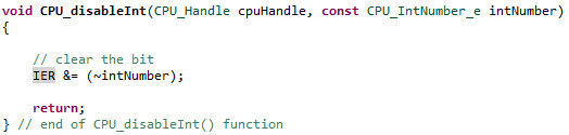

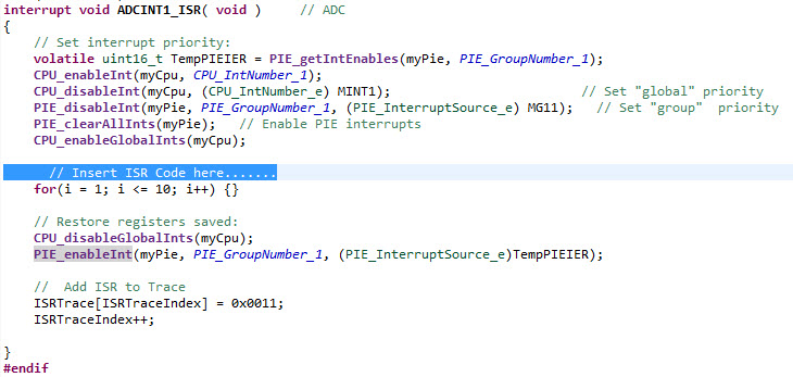

  • hi,
    i read and check the examples that you said want to add them to my motorware project but something confused me.
    in every ISR, at first the program DISABLED the cpu interrupts  and the the pie_group interrupt that have a higher priority but i think, as you said in the post above, the program must ENABE the higher priority interrupts.
    do i understand the program right or no?

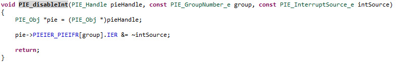

    for example in the ISR shown below, MINT1 and MG11 specified the higher priority interrupt by one. then this two parameter send to CPU_disableInt and PIE_disableInt functions. in this functions the MINT1  and MG11 become NOT and inserted into IER and PIEIER_PIEIFR[group].IER registers.
    i think this operation, DISABLE the cpu interrupts  and the the pie_group interrupt that have a higher priority and must done without NOT in IER and PIEIER_PIEIFR[group].IER registers. am i right?
    i think this functionality
  • i tried this example:
    C:\controlSUITE\device_support\f2802x\v230\f2802x_examples_structs\sw_prioritized_interrupts
    and i am sure that it is incorrect.
    for using this example you must add a NOT(~) before interrupt defined. for example instead of  using MINT10 you must use ~MINT10.
