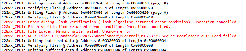

i'm trying to activate the code security module on a tmx320f28377s device but i keep getting an error.
When writing the requested values to the dcsm_otp_z1 sections i get a flash verification error.
C28xx_CPU1: GEL Output:
Memory Map Initialization Complete
C28xx_CPU1: Error during Flash verification (Flash algorithm returned error condition). Operation cancelled.
C28xx_CPU1: Flash verification returned error condition. Operation cancelled.
C28xx_CPU1: File Loader: Memory write failed: Unknown error
C28xx_CPU1: GEL: File: C:\Sandbox\DSP28377SBootloader\MControl\DSP28377S_Secure_Bootloader.out: Load failed.
after this i exclude the ZoneSecurity.asm file so the otp has no information to program and everything works as expected but ofcourse the otp has no data programmed... my link pointers are still at 0xffffffff, this happens on devices being programmed for the first time, so i don't think the ECC is corrupt...

  • Hi Jan,
    Please check the value @ address location 0x1071000 (address for ECC) via CCS memory watch window. All the values should be 0xFFFFFFFF. If not then that's an issue.
    Also which CCS version you are using? Please make sure you have installed all the latest CCS updates (check for updates by clicking on "Help -> Check for Updates" in CCS).

    i checked the things you asked and they all look good. So i build my foirmware and take a look at otp registers @ 0x78000 -> this shows all 0xFF's. Same for 0x1071000. If i try to program i get the failed message.
    in the mean time i was able to program the password by disabling the verify after flash option. And after this i see the zoneselect bytes are correctly programmed (0x78020) but the otp region (0x78000) still reads all 0xFF's while the last 32bits (Z1-BOOTCTRL) should have been 0x0000FF5A....
    So it seems only the dcsm_otp_z1 section fails to program...

    We don't see any issue with programming of linkpointers. Could you take a snapshot of  memory view, starting location 0x78000/0x78200 and post it. Also please check your map file to make sure these values are getting assigned to correct address location. If possible, attach your project file also.

    afterwards i include the asm security asm file but then i get the verification error (i only use zone 1 so i didn't take pictures of 0x78200)
    if i disabled verify flash i get following programmed memory space: (i erased the password)
    and the password is programmed correctly. To me it seems the dcsm_otp_z1 section doesn't get programmed, the dcsm_zsel_z1 does. the otp values remain unchanged except for the bootctrl-word. These are the values i tried to program:

  • Hi Jan,
    After further debug we found issue with existing example code which prevents it from programming the BOOTCTRL values in OTP. We have updated the example code and I am attaching updated example code here for your reference. Please have a look at .cmd and .asm file and modify your code accordingly and see if that fixes the issue.

  • Thanks Vivek,
    this solved the issue.
