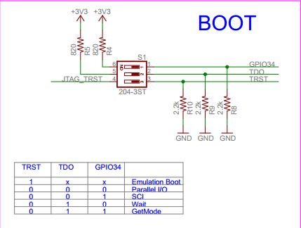

I have been unable to connect to my LAUNCHXL-F28069M Launchpad. I have tried it on four different computers now, 3 with CodeComposer v6 and one with CodComposer v5. When I select "XDS100v2 USB Debug Probe" for the connection and click on the "Verify" button, I get the same error messages on all four computers. I am including the error log below. One of these computers was being used to develop code for F28335 systems successfully just before connecting the Launchpad and worked properly with the F28335 afterward. Do I have some setting wrong or is my LaunchPad defective?
Thanks in advance.
