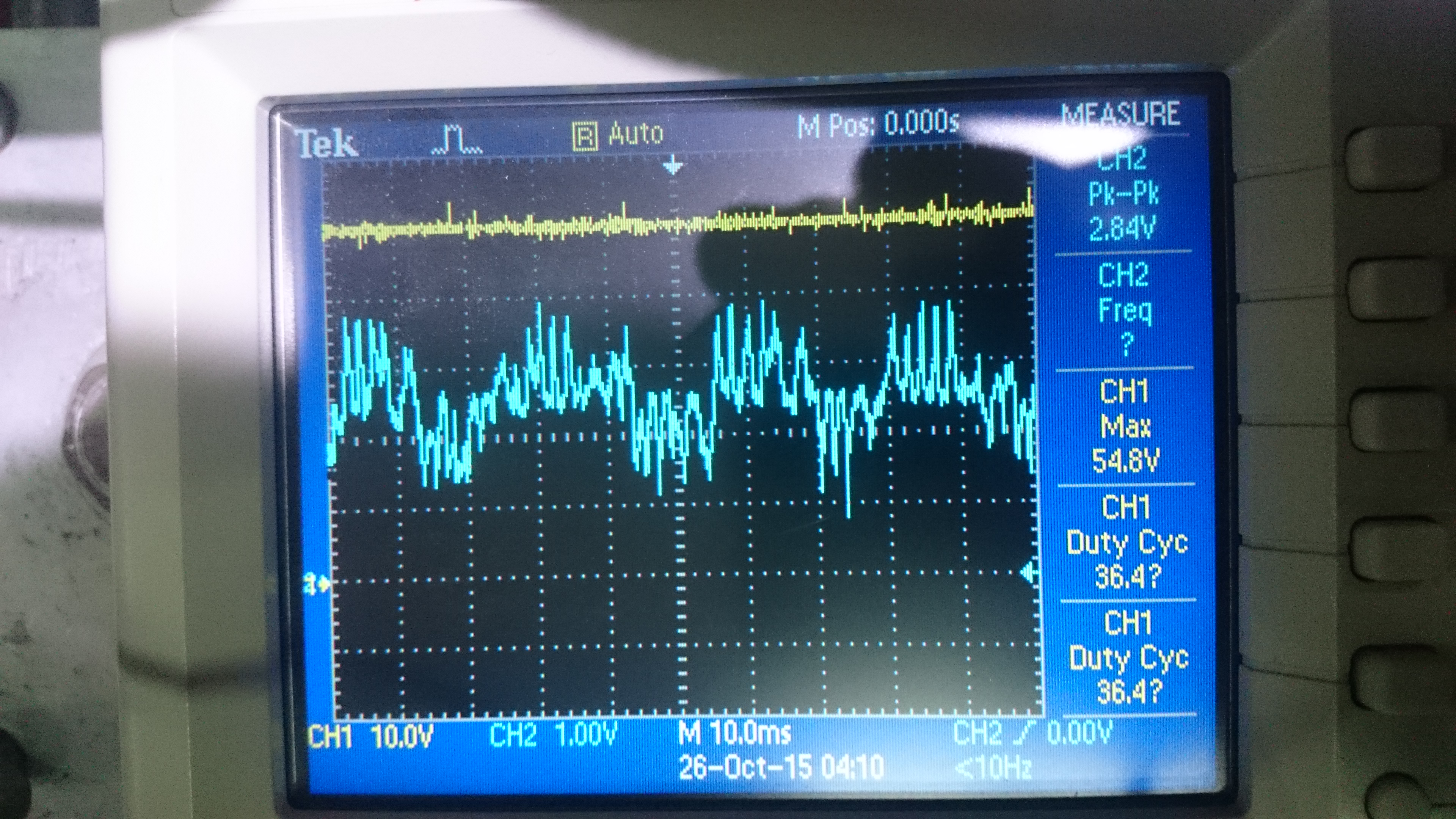

    When my motor get unstable with sound. I noticed that my current current sensor out put get deformed as below. At that time PWM runs at it's maximum duties.
    The blue channel shows the senor out put signal. Is this happened due to hardware issue or firmware issue ?

  • Not sure Lakshan, but have you tried giving some headroom to the USER_IQ_FULL_SCALE_CURRENT_A value by adding 20-30% (240-260) with subsequent increase to USER_ADC_FULL_SCALE_CURRENT_A?
