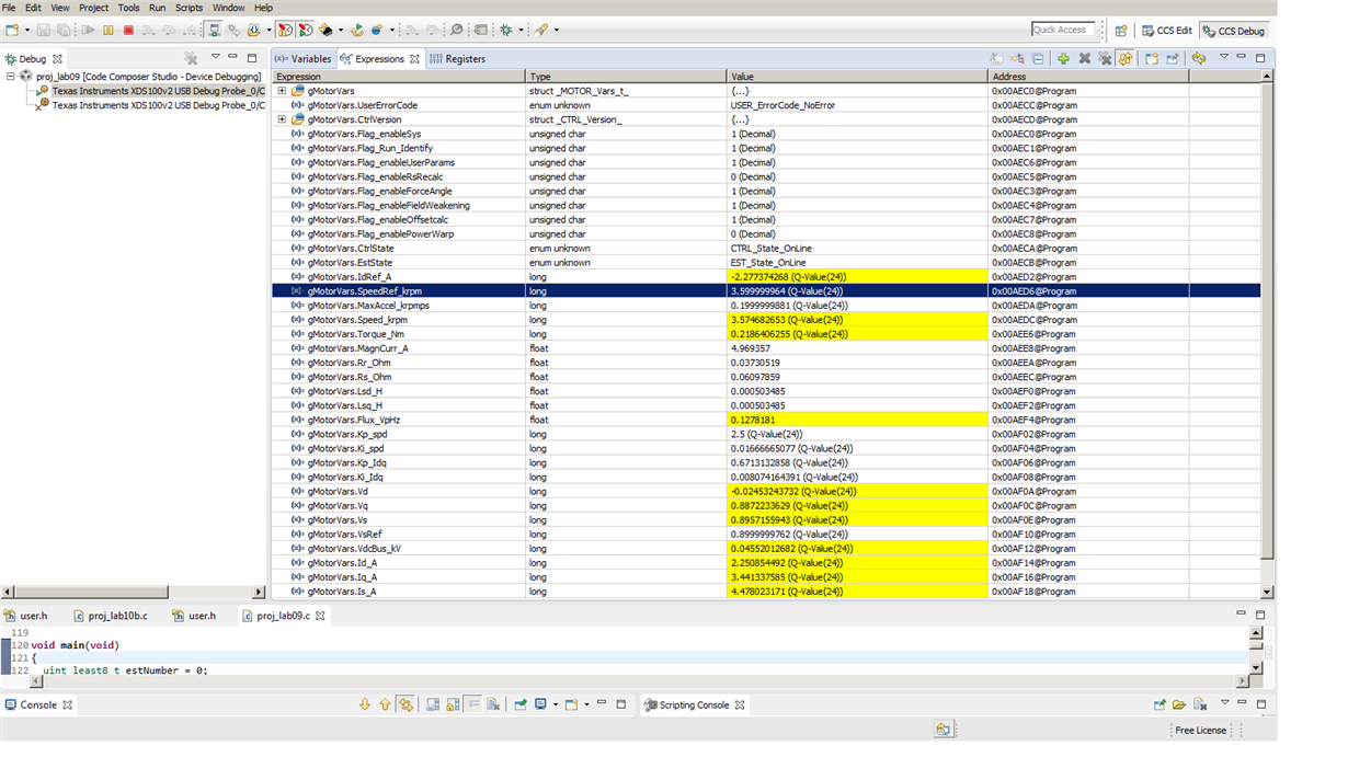

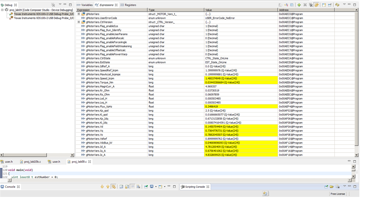

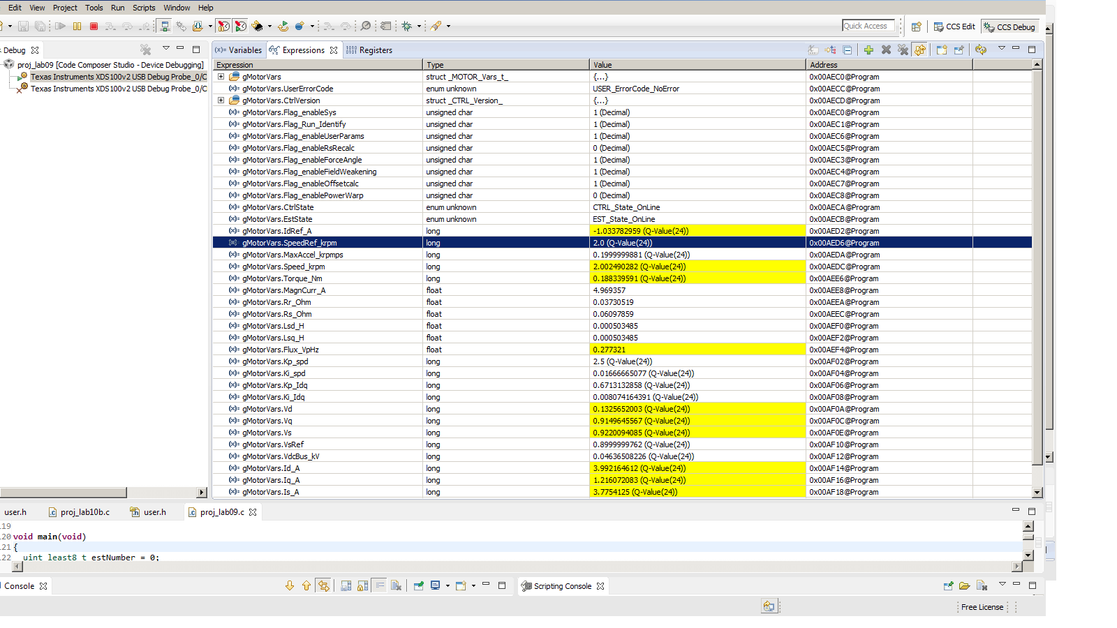

    Lab9 - 1.4Krpm
    Lab9 - 2.0Krpm
    Lab9 - 3.6Krpm

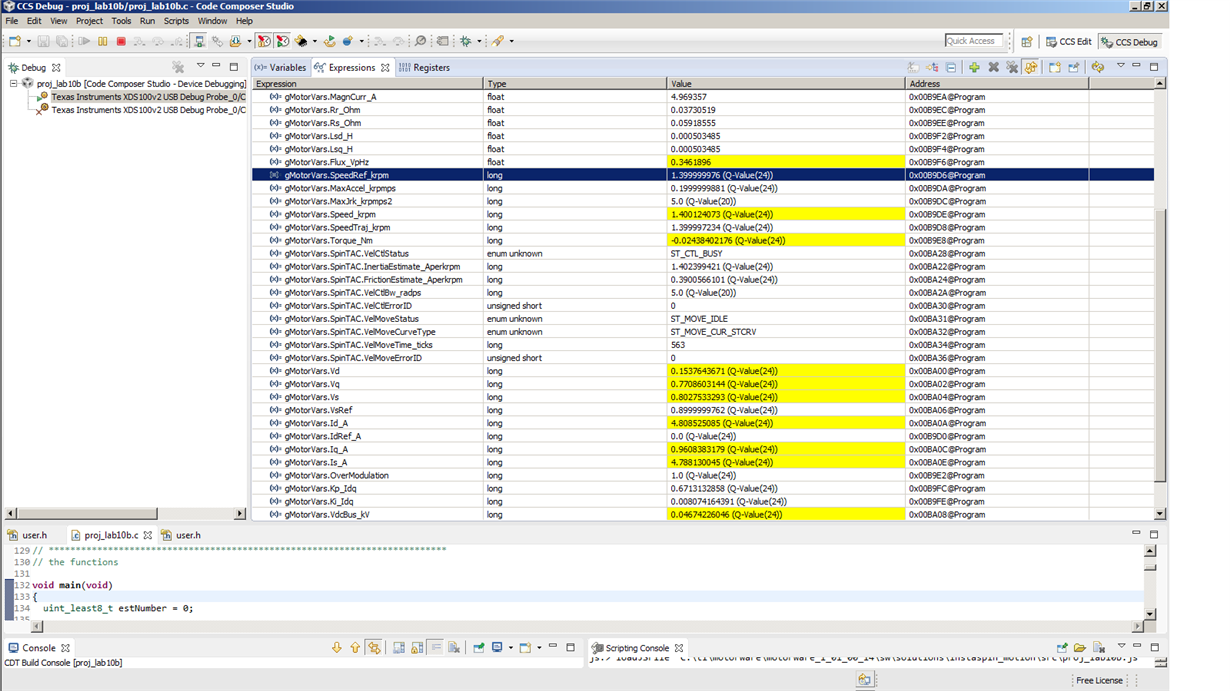

    Lab10b - 1.4Krpm
    With these pictures can you see anything wrong ? Or anything that I could try ? Do you recommend I do any other test ?

    Nothing that you showed seems like there are any issues.  I'll try to run a motor tomorrow and see if I can reproduce your case.  There are a couple things you could try.
    1. You can try enabling PowerWarp instead of using field weakening.
    2. One difference between lab 9 and lab 10b is that 10b also includes overmodulation.  You can try removing the overmodulation code from lab 10b to make it more similar to lab 9.

    I removed the overmodulation code from lab10b and the results are good:
    Lab10b -
    The field weakening is working well and I could accelerate the motor to 3.6Krpm with the gMotorVars.SpinTAC.VelCtlBw_radps (5.0). If I increase this variable the motor starts to oscilate.
    Disabling the Field Weakening and enabling the Power Warp the motor reaches 3.6Krpm with the gMotorVars.SpinTAC.VelCtlBw_radps (2.0). If I increase this variable the motor starts to oscilate.
