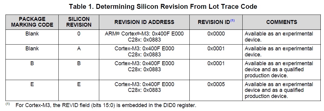

  • John,
    Could you also check the revision of silicon on which you are seeing this failure ?
    Vivek Singh
  • Hi Vivek,
    We have been testing with two boards. One of the boards has a Revision 0 part and the other board has a production revision B part. Of note, this issue occurs more frequently on the board with a revision 0 part, usually once every 2-3 days. On the revision B board, the issue occurs generally after about 5-6 days.
    John
  • Hi John,
    Thanks for providing the info. We have following advisory in Errata document for this device -
    "Advisory C28x Flash: The SBF and BF Instructions Will Not Execute From Flash"
    Though this should only impact Rev-0 device but I would still suggest to see if this condition applies to this case (have SBF/BF instruction in your code) and if yes, then try the suggested workaround  to see if that fixes the issue.
