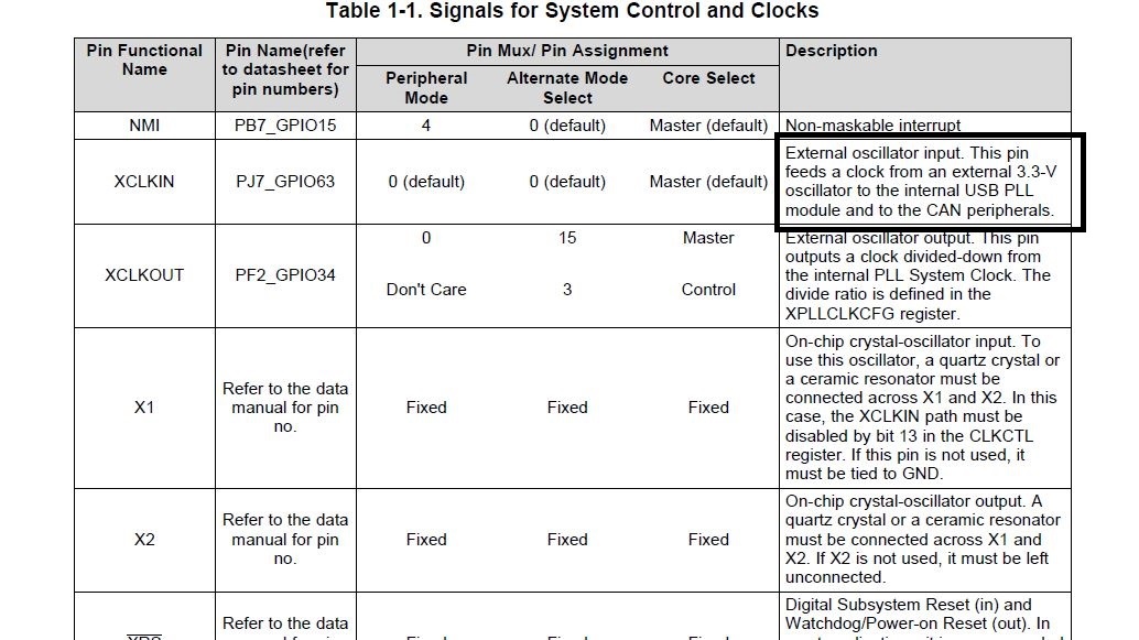

Hello Sir,
I have question for USB for F28M35H52C1.
I have attached one snap. In that written like "Extern Clock required from xclkin for USB."
Please answer about that "Is it necessary to give clock from external XCLKIN ?"
  • Hi Sandip,
    Internal is also enough! Not necessary for external.

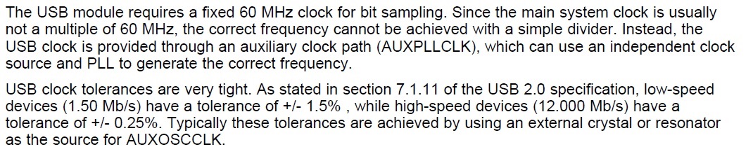

  • Sandip,
    Please refer section "2.7.3.5 USB Auxiliary Clock (AUXPLLCLK)" in TRM.
    This has following statement which answers your questions -
    "USB clock tolerances are very tight. As stated in section 7.1.11 of the USB 2.0 specification, low-speed devices (1.50 Mb/s) have a tolerance of +/- 1.5% , while high-speed devices (12.000 Mb/s) have a tolerance of +/- 0.25%. Typically these tolerances are achieved by using an external crystal or resonator as the source for AUXOSCCLK."
    Vivek Singh
  • There is no Section Like "2.7.3.5 USB Auxiliary Clock (AUXPLLCLK)" in Technical Reference Manually.
    I am talking about F28M35H52C1. I am seeing in Tech. Ref. Manual of this controller.
    Please refer and reply me as soon as possible.
    Sandip Rakhasiya
  • Sandip,
    You are right. I referred F28377D TRM but the requirement is for USB hence it's valid for any device with USB. Following is the snapshot -
