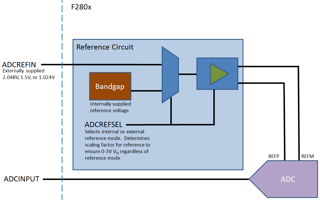

  • Hi Golgor,
    Everything is working exactly as it should.  The F2808 ADC full scale voltage is always 3.0V regardless of what reference mode is selected.  The purpose of external reference mode is so that a more accurate reference can be used to reduce the gain error.  Multiple options are provided in common reference voltages for convenience, but the full scale voltage does not ratiometrically scale with the reference voltage.

  • The ADC user guide details how to configure the device for internal vs. external reference mode.  We specify different gain error limits in the datasheet (ADC Electrical Characteristics) depending on internal vs. external reference with external reference being better.  Of course you have to account for any error introduced by your external reference.
    In the device the reference voltage and ADC input voltage are scaled to matching ranges depending on the mode selected.  The ADC result registers will always give you something around 0 for an input of 0V and something around 4095 for an input voltage of 3V regardless of the reference mode.  I say "something around" since you have to account for offset, gain, and linearity error as well as noise.

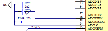

  • Hi TI
    Below is a part of the circuit, including the TMS320F2808, that Golgor and I are working on. Depending on which ADCINA pin we connect the resistor and capacitor to, we measure between 17 mV and 27 mV across the resistor. Why is the voltage across the resistor different from 0 V? What causes this leakage current through the resistor and can you elaborate on this leakage current's characteristics?
    Vcc = -DC
    If we set the ADCOFFTRIM to an offset value, will the automatic gain error correction (GEC) calculation based on an external reference be redone so that we get an error correction like this y = GEC*x+ADCOFFTRIM?

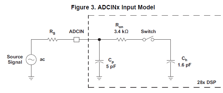

    Does the leakage current on the ADC input mean that the generator impedance of the signal source must be low enough as to avoid or reduce impact from this leakage current?

  • Golgor said:
    The F2808 is used in a product that is about the be phased out in a couple of years and I seriously doubt there will be resources for changing DSP.
    Understood, hopefully F280x will work for this application as well.
    Golgor said:
    We are just curious, what does the external reference do in this device, do you know?
    Using external reference has the same function as using the internal bandgap, namely to provide a reference voltage which the ADC input is compared against to determine the digital code.  Sometime the bandgap can contribute a significant amount of error to the reference voltage, in particular temperature drift.  In the case of F280x we see the error due to the buffer after the mux and/or in the converter itself >> than that of the band gap, therefore selecting the external reference option doesn't offer an improvement.  Note, the below picture is conceptual and does not necessarily reflect the actual implementation/architecture.
    user4531652 said:
      Is there any way to make an offset trim without using the regular ADC inputs (but instead to use VSSA2) and what drawbacks would you expect considering the possibility that the offset might be negative?
    Some other C2000 devices have an internal connection to REFLO or VSSA allowing them to be sampled without sacrificing an ADC input, but I'm afraid that is not the case for F280x.
    Yes, but in addition to leakage, there will be active current as the internal S/H cap charges during sampling.  You may have to increase the sample and hold time to let the cap fully charge.  Note the below input model is not from F280x documentation but the principle is the same.
