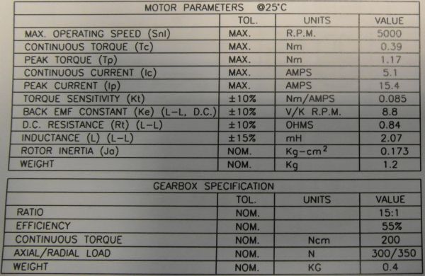

Instaspin cannot reach max RPM
I'm using the Launchpad XL (TMS230F28069M) with the BOOST-XL-DRV8301 REV B Motor Drive BoosterPack.
The PSU that i'm using for this board is 24 VDC.
The motor is a BLDC motor with a 15:1 gearbox attached to it.
When i'm using a different BLDC motorcontroller i can get the speed up to around 2700 RPM with a PSU of 24V.
With InstaSPIN i can only get it to around 1300 RPM, i expected it to be about the same as the other controller.

  • 1. how do you know USER_MOTOR_NUM_POLE_PAIRS (2) is correct?
    2. your identified inductance looks lower than the nameplate. I would try to ID this motor again to see if your results differ. Increase
    USER_MOTOR_FLUX_EST_FREQ_Hz (40.0)
    make sure that the motor starts and remains spinning during the ID process. If it doesn't start-up increase
    USER_MOTOR_RES_EST_CURRENT (1.0)
    do remember that in most of the labs you limit your max speed due to a limit of sinewave generation. if you want to increase the PWM modulation use lab10 to get another 25% increase in speed. Your speed is so far off though that I suspect something else is the main culprit.
    once you get this solved you will need to increase this to insure you can generate peak current commands
    #define USER_MOTOR_MAX_CURRENT (16.0)
  • 1. I asked the manufacturer about the number of poles and they said it was 4. There is also an encoder connected to the shaft which i used to verify the speed. And the gMotorVars.Speed_krpm is about the same as what the encoder tells me. (i connected the encoder to the other controller to view it).
    2. I forgot to tell that i also had problems with measuring the ID of the motor. Especially USER_MOTOR_Ls_d and USER_MOTOR_Ls_q.
