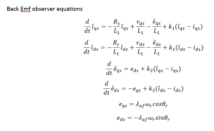

I am building the PM_sensorless example project from controlsuite in code composer v5.4. This project uses SMO to estimate rotor position and speed. I want to replace the SMO block with a back-emf observer. How do I go about implementing this in code? I am using the DRV-8312-C2-kit with the TMS320F28035 Microcontroller.
the screenshot shows the back-emf observer equations.
Any help will be much appreciated.
