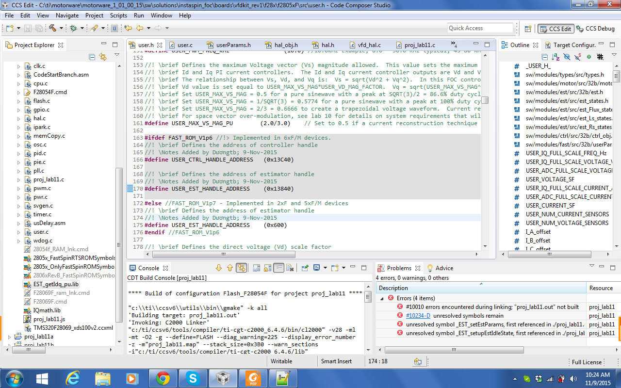

I am studying proj_lab11 in order to porting it from F28069F to F28054F. However, when doing a build for the orginal project I got three errors as the following figure:
The linking noticed that:
#20 identifier "USER_CTRL_HANDLE_ADDRESS" is undefied
#20 identifier "USER_EST_HANDLE_ADDRESS" is undefined
#20 identifier "USER_VD_SF" is undefined
I checked these CONSTANTS in user.h but not found! Has anybody met these errors with Lab11a or Lab11b yet?

  • Hi Tran,
    Please reinstall MW15 into another directory and confirm that Lab11.c compiles without errors. It should. If it does compile with no errors, then do a file comparison with the SW you are using now and let us know what changes were made. I am expecting the project properties have changed.
    There is probably a file path issue with user.h, the file where USER_CTRL_HANDLE_ADDRESS is defined. Look closely at your project properties: Include Options and Linked Resources.

  • Hi Jeff,
    I've just reinstall MW15 and run Lab11.c for F28060F and the build is successful. I checked the parameters in the user.h, and I confirm that:
    //! \brief Defines the address of controller handle
    #define USER_CTRL_HANDLE_ADDRESS   (0x13C40)
    //! \brief Defines the address of estimator handle
    #define USER_EST_HANDLE_ADDRESS    (0x13840)
    //! \brief Defines the direct voltage (Vd) scale factor
    #define USER_VD_SF                 (0.95)

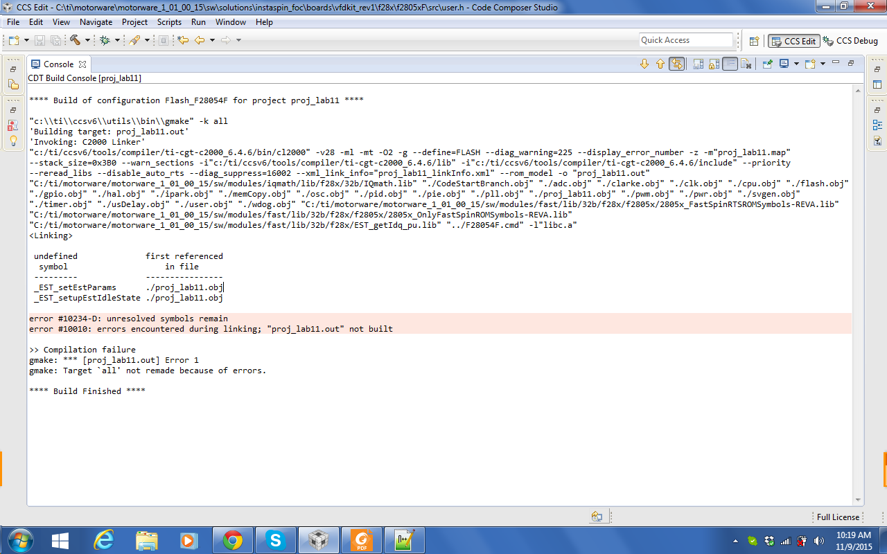

    But I am wanting to port this project (Lab11.c for F28069F) in order to run with F28054F, because I bought chip F28054F for my own board. Whether this project can run well with F28054F or not? and what can I do to port Lab11(a.b) to run on F28054F because I got some errors when porting to F28054F from the original project (F28069F).
    For more detail please see the following figure: notice that having errors in linking with the libary EST_getIdq_pu.lib and EST_setEstParams() & EST_setupEstIdleState() functions.

  • Hi Tran,
    Lab 11 is not compatible with 05x since this device has dual security zones with the estimator functions are locked in zone 1. This is a problem since Lab 11 was restructured to make direct calls to the estimator, which is fine with 02x and 06x since these devices do not have the dual-security zone feature.

  • Hi Jeff,
    Thank you for your reply to my question. I ported the Lab11 from F28069F to F28054F and resolved these above errors by adding two libraries into the project that built for F2805x:
    \sw\modules\fast\lib\32b\f28x\EST_setEstParams.lib, and
    \sw\modules\fast\lib\32b\f28x\EST_setupEstIdleState.lib
    The build was successful. You can look at the result in the following figure:
