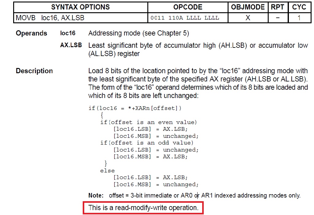

  • Hi Stephen,
    C28x is 16bit machine. It does not support byte access and so the peripherals.
    MOVB instruction (byte intrinsic) is actually READ modify WRITE (RMW) instruction to update the 8bit.  As I mentioned earlier, RMW operation should be avoided with GPIO DAT register and use SET/CLEAR register instead.
    Vivek Singh

  • Stephen,
    The MOVB instruction is actually a read modify instruction. CPU will  read 16bit, update the byte which need to written and then again do a 16bit write. This is how it updates the 8bits.
    If you have enough time difference between two successive write then I agree, #1 may not be concern for you. But why don't you want to use the SET/CLEAR register? So you see any issue with that?
    Vivek Singh
  • Hello Vivek,
    "The MOVB instruction is actually a read modify instruction. CPU will  read 16bit, update the byte which need to written and then again do a 16bit write. This is how it updates the 8bits."
    According the the TMS320F28X CPU instruction set and reference guide (SPRU430F) shown below, the instruction only affects the lower 8-bits. Therefore, only the low 8-bits of the 32-bit register would be affected.  Is that correct?

  • Hello Vivek,
    In the instruction description for the MOVB instruction, what does "unchanged" mean?
    Does that mean that the other part of the 16-bit register is not written at all?
    I would think so because the description says "load 8-bits of the location pointed to by location "loc16" addressing mode...."
    Testing the scenario where 16-bits are loaded back into the register would be impossible to do.
    Stephen
  • Hi Stephen,
    Unchanged means it'll be written back with the same data. For example if register had value 0x1255 and you are tying to change the 8bit LSB (8bit) to 0x55 then value 0x12AA will be written back.
    If you look at the definition of the MOVB instruction (which you posted earlier), it clearly says that it's a Read Modify Write operation.
    Please go through this link as well which has more detail on this.
    Vivek Singh
