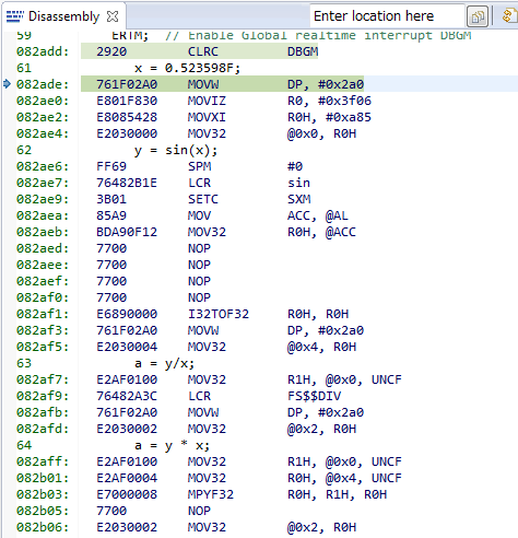

We use control card of F28075.
We try to execute this code.
float32 a,x,y;
 x = 0.523598F;
 y = sin(x);
 a = y/x;
 a = y * x;
We calculate on CCS
Run -> clock -> enbale
this cycle is 145 cycle.
but we include math.h.
#include "math.h"
float32 a,x,y;
 x = 0.523598F;
 y = sin(x);
 a = y/x;
 a = y * x;
this cycle is 308 cycle.
Do you know why ?
Best Regards
Hiroyasu

  • Hiroyasu-san,
    The F28075 has the TMU (trig math unit). You can use it to minimize execution time. You enable it in the project properties by setting --fpu_support=fpu32, --tmu_support=tmu0, --fp_mode=relaxed. You dont have to change your code, the compiler will automatically substitute TMU instructions for the sine and divide operations.
    Now to the original problem itself, can you post the disassembly of the snippet you have shown, with and without math.h? Also could you post the compiler settings
  • Hi, Vishal_Coelho
    I show you disassembly without math.h and compiler Setting.
    blinky_cpu01.zip
    I understand We use TMU without math.h.
    but I do not understand why F28069 is not delay with math.h.
    Do you know why?
    Best Regards
    Hiroyasu

  • Hi, Sorry i didnt see your reply. I checked out your code - i dont see the changes you made. The project files link to the source code in controlsuite. you probably changed the blinky.c file but did not package it with this zip. In any case i put in your code and this is what i get for the case where math.h is not included (by the way, I see a warning that sin is declared implcitly)
    It takes 115 cycles (sin = 67, divide = 5, x = 0.523598, y = 0, a = 0 ), calls the sin and FS$$DIV functions from the standard run-time support library BUT y = sin(x) gives 0 which when you feed as an argument to divide will cause it to jump to the last branch(divide by zero branch) and exit, which is why it takes 5 cycles
    Now when i include math.h it takes 307 cycles (sin = 67, divide = 233,  x = 0.523598, y = 0.4999993, a = 0.9549298 then 0.2617987) , the additional cycles is from the FS$$DIV() but the answers are all correct
    In the first case (without math.h) sin was called it calculates 0.499993 and stores it in R0H, but then the compiler overwrites this value with what is in the accumulator (probably 0) and then passed it to the divide function, which is why it executes quickly (divide by zero exit)
    63      	 y = sin(x);
    0080a7:   E2AF0044    MOV32        R0H, *-SP[4], UNCF
    0080a9:   FF69        SPM          #0
    0080aa:   7640B793    LCR          sin
    0080ac:   3B01        SETC         SXM
    0080ad:   85A9        MOV          ACC, @AL
    0080ae:   BDA90F12    MOV32        R0H, @ACC //<---- R0H is being overwritten by ACC (0)
    0080b0:   7700        NOP
    0080b1:   7700        NOP
    0080b2:   7700        NOP
    0080b3:   7700        NOP
    0080b4:   E6890000    I32TOF32     R0H, R0H
    0080b6:   7700        NOP
    0080b7:   E2030046    MOV32        *-SP[6], R0H
    64      	 a = y/x;
    0080b9:   E2AF0144    MOV32        R1H, *-SP[4], UNCF
    0080bb:   76408000    LCR          FS$$DIV
    0080bd:   E2030042    MOV32        *-SP[2], R0H
    Now in the case where you include math.h, you see the difference immediately, R0H is preserved before calling divide
    63      	 y = sin(x);
    0080a9:   FF69        SPM          #0
    0080ac:   E2030046    MOV32        *-SP[6], R0H
    64      	 a = y/x;
    0080ae:   E2AF0144    MOV32        R1H, *-SP[4], UNCF
    0080b0:   76408000    LCR          FS$$DIV
    0080b2:   E2030042    MOV32        *-SP[2], R0H
    The compiler does give a warning that sin() is implicitly declared in the first case, so it does not know that the output of sine (in R0H) is going to be consumed by a later functions and just overwrites it.
