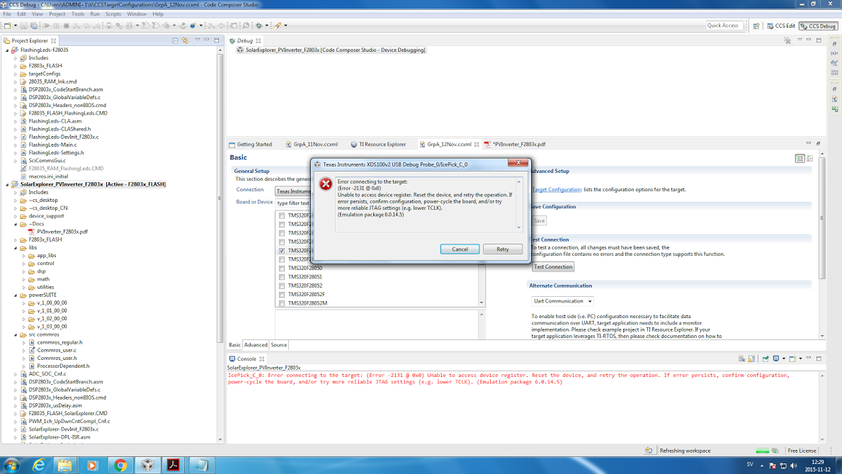

Hence, we tried to connect via the mini-USB port that connects to M5 and the PV-emulator. We discovered that this actually resolves the previously described issues and following the same procedure as above, the db jtag indicates that there is an established connection. In particular, the error message e-150 disappears and the lamp on the main-dsp blinks. Subsequently, the build process in CCS progresses for a couple of minutes before the following error message appears:

    Note that it is possible for CCS to get confused as to which emulator is being used if both USBs are connected.  For simplicity, I would recommend that you either connect a USB cable to [M7]-JP1 (the inverter's USB) or connect a USB cable to [M5]-JP1 (the panel emulator's USB).
    F28027 -
    When you say that you are able to connect CCS via the mini-USB connector, you are connecting to the F28027.  When using this, make sure that you are loading the PV emulator software to it and make sure that your target configuration is xds100v1+F28027.  If done, this device should run and should not give you issues - ie should not lose emulation after running for a few minutes.  If you are not doing this, can you try this?
    F28035 -
    Based on your description, you have not been able to connect up to the F28035 at all yet.  When you are trying to connect to the controlCARD, make sure that the controlCARD is powered - make sure that LD1 on the controlCARD is lit.  You should also make sure that [Main]-J4 is populated - see picture below.  Please check this.
