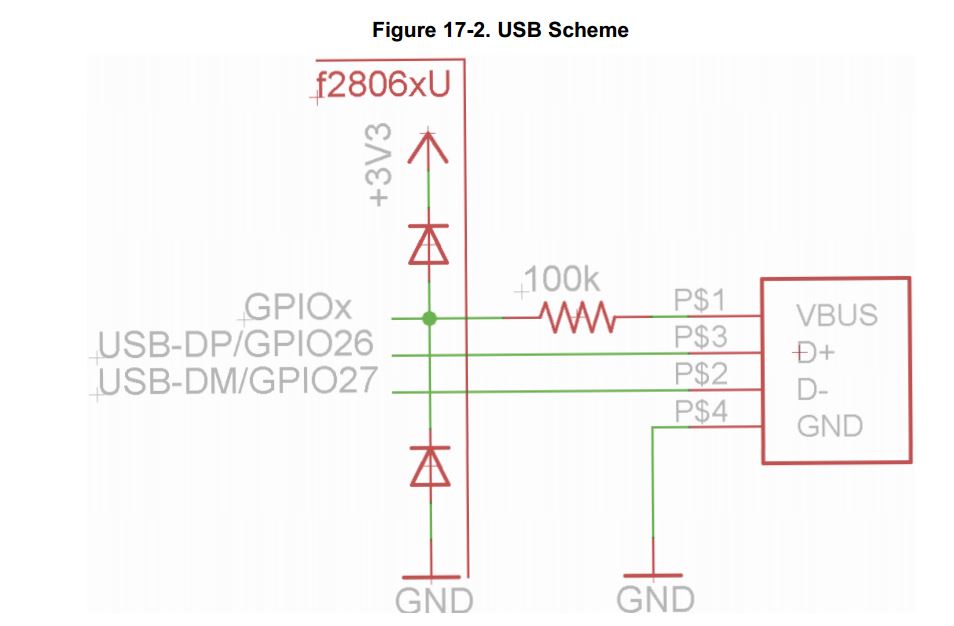

I would like to test the USB functionality present on the TMS320F28069M. I have a launchpad, and noticed that the USB pins were broken out as GPIO's. Would I need to create a small breakout board for the D+ and D- pins in order to fully test USB applications?
In the Getting Started sheet for the launchpad, there are Mux options for deciding different types of serial connectivity. However, I am having some trouble deciphering what they mean. Any guidance is appreciated!
