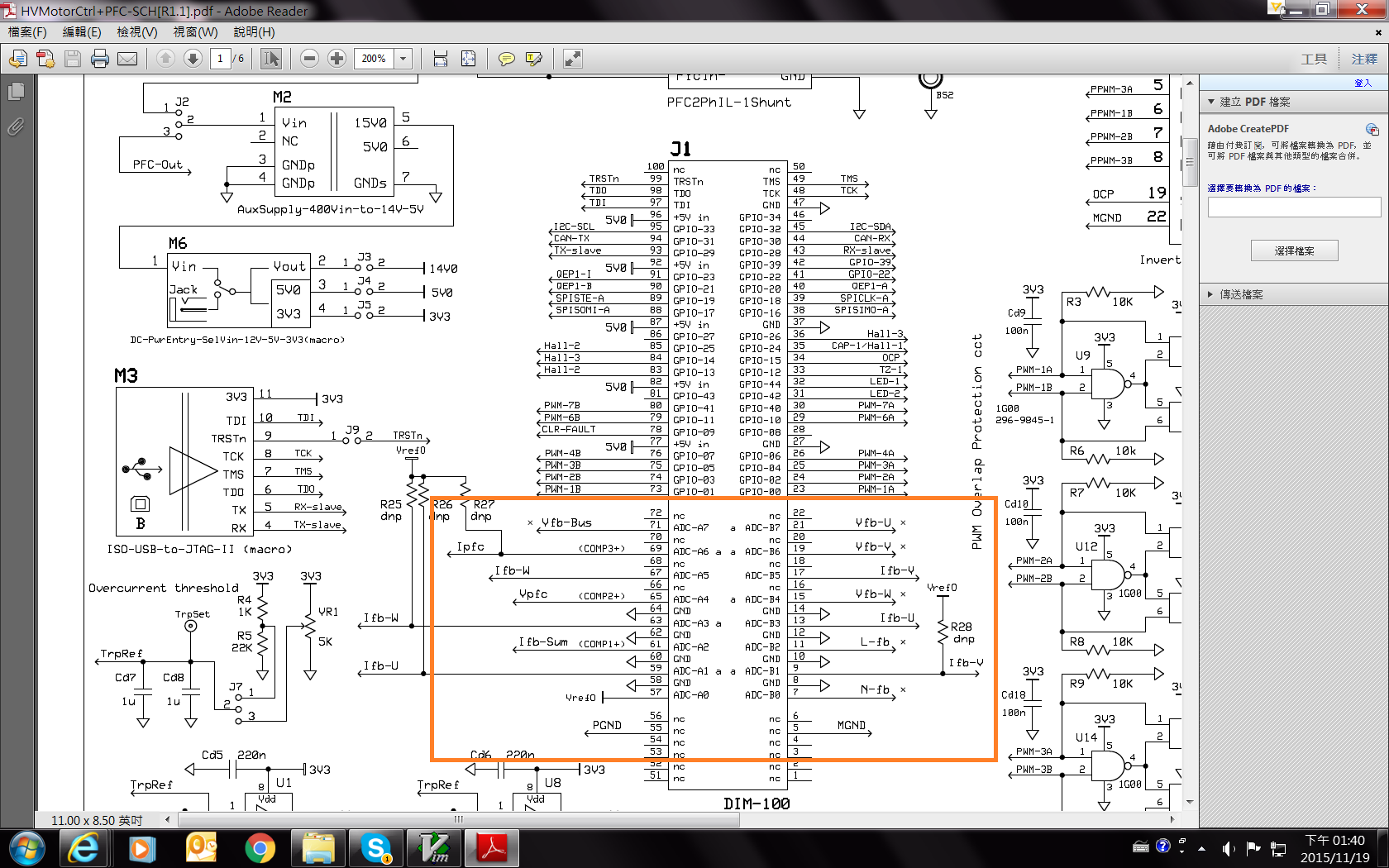

  I am running a motorware project on Lab12b in the "Hv-kit+F28069" and I would like to add one channel of ADC for torque feedback.
I found it seems no extra ADC channel available to connect the feedback of torque force. Below is the layout of ADC in the Hv-Kit.
ADC-A0: Vref0, ADC-A1: Ifb-U,ADC-A2: Ifb-Sum, ADC-A3: Ifb-W, ADC-A4: Vpfc ,ADC-A5: Ifb-W, ADC-A6: Ipfc ,     ADC-A7: Vfb-Bus
ADC-B0: N-fb  , ADC-B1: Ifb-V,ADC-B2: L-fb,        ADC-B3:Ifb-V , ADC-B4:Vfb-W ,ADC-B5: Ifb-V, ADC-B6: Vfb-V ,   ADC-B7: Vfb-U
How can I use extra ADC channel ? Could I use the above ADC channel(ex. ADC A4) to measure torque force?
