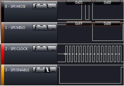

  • According to the EEPROM that I use, when the Chip select line (inverted logic) gets raised (de-select the chip) it ends the read commands.  When I include the line:
    while(SpiaRegs.SPISTS.bit.INT_FLAG != 1){}
    instead of
    while(SpiaRegs.SPISTS.bit.BUFFULL_FLAG == 1){}
    I get the following wave form on the logic analyzer.
    This stops the command. (note during the second set of clocks the MISO line is high)
    This is what I get when I used, the code I attached.  (The wave form should look like this.)
    (note during the second set of clocks the MISO line is low;  this is what is expected)
    When I do the read of the SPIRXBUF, however, I get 0xFF.  In order to capture data from the line I need to send another character to the SPITXBUF before I can read the actuall data.
    After I dump that first character I can read data continuously, but I always have to dump the first value from the SPIRXBUF.
  • John,
    How are you driving the SPI enable line? And when?
    Also, the second picture shows me that the SPI is actually working perfectly.  During the first read of SPIRXBUF it gives 0xFF because that is what is on the line at the time of transmission.  The second read gives the appropriate data.  This is probably how the EEPROM chip itself works:
    1) Send command.  During the command being sent the MISO line is idle - Thus you should read 0xFF - it is what is on the line at the time of transmission
    2) Then for each dummy TX you get meaningful data back, as the EEPROM has fully received the command and has processed it.
    The BUFFULL approach seems to actually be working.
    Tim
  • Tim,
      I am allowing the SPI mechanism on the piccolo chip to drive the SPI enable line.  The chip takes the appropriate actions from what we set up in the spi control register (i.e. I have set up inverted logic for the SPISTEA pin) when I write to SPITXBUF.  At least that is what I assume, because that is what is happening :)
    (I used to "manually" drive the SPISTEA pin but then, through trial and error, found out this wasn't really doing anything.)
      You are correct in saying that the second picture is showing the SPI working correctly.  And that is the nugget of my issue.  I see the SPI working with the logic analyzer, but when I read the SPIRXBUF after the second transmission I get a value of 0xFF, when I should be getting 0x00.  Reading the SPIRXBUF only returns the correct value after I write another character to the SPITXBUF.  (When reading a block of data every read after that is in sequence, but I always have to throw away the first byte of data.)
    I will go back and see if I can get the SPISTEA line to work manually for me.  Then perhaps I can try using the INT FLAG with better results.
    John

  • Mitja,
      The data sheet says that SPIRXEMU is used for emulation purposes only.  I am not sure if this means it is unusable or there is some issues with it's use.
    Tim,
      I have been able to drive the CS pin manually.  This has cleared up my issue with checking for INT_FLAG.  What I noticed with this is that there must be an issue with the copy rate from the SpiaRegs.SPIDAT register to the SpiaRegs.SPIRXBUF.
    At any rate this cleared up not being able to read from the SPI port correctly.
    The only downfall of this is that it effectively brings the data rate down to about 907k 800k baud for any read function, (which is down about 10%  20% from 1M baud that they claim).
    I wouldn't call this solved but I do have a work around for now.  I will keep working on a better set of code to remove the delays that I am seeing with the read functionality.  If/when I get to that point I will post my code to this thread.
