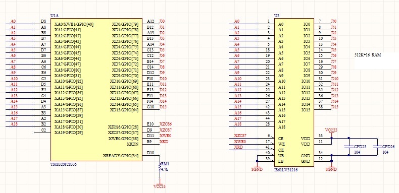

I add a external ram IS61LV51216 on my 28335 board, as shown below.My question is how can I map the ram to zone7 in programm. Can it be maped to zone6? What's the deference in programm?
  • Zhang,
    You have the SRAM mapped to Zone6 because you have connected the XZCS6n pin on the F28335 to the CEn pin on the SRAM.  If you want to map it to Zone7, you would connect XZCS7n to CEn.  Both program and data space are mapped together.  There are no separate strobes for program and data, just the XZCSn strobes.
    It should matter to you whether you have the SRAM mapped to zone6 or zone7.  The only difference between the two is the base address of the zone.
    David
  • Hi David
    Thank you for your reply.
    There is a little mistake about you. I have connected the XZCS7n pin on the F28335 to the CEn pin on the SRAM, so only zone7 can be mapped .

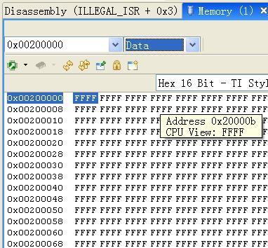

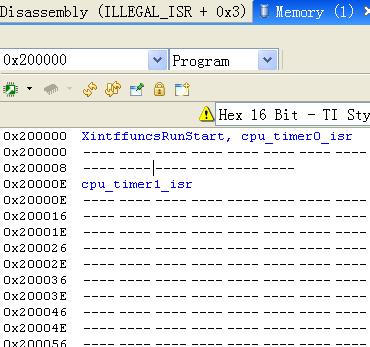

    But when I uncomment the two lines, it runs to the ILLEGAL_ISR().
    when i open the memory watch window, the programm at 0x200000 show as below
    the data are all FFFF, and the data can not be modified.
    Is there some mistakes or the external ram is damaged? How can i check wether the ram is damaged?

  • Zhang,
    Forget about the code for now, and focus on CCS and the external memory. You have your CCS target configuration setup for F28335, right? It will use the GEL file F28335.gel located here: C:\TI\ccsv6\ccs_base\emulation\gel. Did you uncomment the call to XINTF_Enable() in the OnReset() function in the .gel file?
    I uncommented the XINTF_Enable() and saved the .gel file. I then started CCS and connected up to my eZdspF28335 development board. This board has external SRAM in Zone7. After connecting to the target in CCS, I can view/change the contents of the external SRAM in a memory window at address 0x20_0000. You should be able to do this too, or something is wrong. The board connections should be debugged. You can start by checking XZCS7n strobe with a scope when an access is made. Do you see it pulse? Check at the SRAM.

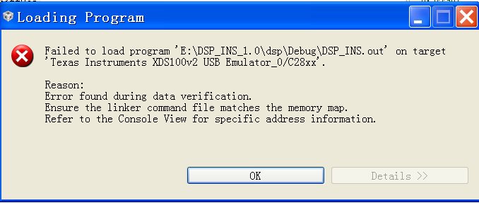

           There must be some mistake on my board, and I can not debug it in a short time. I change another board which connect the ext ram to zone6. The board is reliable and the 'xintf_run_from' and other examples  run correctly on it. Because my programm is too big, I want to run some functions in the ext ram,but  I can't load the .out file to the ext ram, and it shows
    I don't konw where are the mistakes, please help me. My programm and the schematic diagram can be find in the attachment. Thank you.
    Regards.
    Zhang

  • Zhang,
    Check your F28335.gel file (in CCS) to see that it is enabling the XINTF zone6.  CCS cannot load code into the XINTF unless the XINTF is enabled.  In the function OnReset(), you need the XINTF_Enable() GEL function UNCOMMENTED.

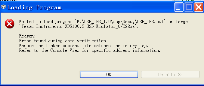

  • David
      I  checked my gel file,  the XINTF_Enable() GEL function is UNCOMMENTED.
      I  replace the OnReset() function with your code, but it also shows the error information I said.
    the console window shows that
    XINTF x16 enabled by GELC28xx: File Loader: Data verification failed at address 0x00104FFD Please verify target memory and memory map.
    Error found during data verification.
    Ensure the linker command file matches the memory map.
    Regards.
    Zhang
  • Zhang,
    It appears that your XINTF is not getting initialized correctly. Forget about loading code. If initialized correctly by CCS, you should be able to open a memory window to an external memory location, and then change the value in CCS. If you refresh the memory window, you should see the external memory signals activate (e.g., CSn go active, address lines driven, etec.).
    - David
