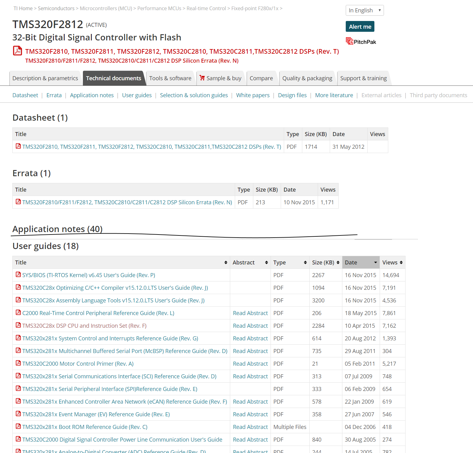

  • Hi Sal,
    You can find supplementary device documentation like the CPU instruction set guide on the "Technical Documents" tab for each device:
