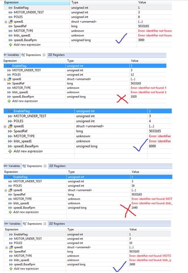

BaseRpm calculation in BLDC_Sensored.c
From the code, BaseRpm = 120 * BaseFreq / Poles.
BaseFreq is set 200 as a constant.
If I set the Poles to be 8, I get the correct value of BaseRpm = 3000 RPM.
But if I set the Poles to be 12, I get BaseRpm = 1920 (it should be 2000 RPM). If Poles = 16, I get BaseRpm = 1440 (it should be 1500 RPM).
Can somebody explain this?
In DRV8312GUI_Main.c, the formula for BaseRpm is the same but there I see always the correct calculated BaseRpm.
