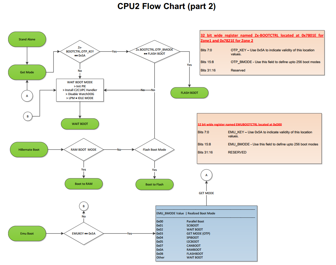

  • Hi, Manoj
    According to CPU2 Flow chart as shown below, if ZxBOOTCTRL.OTP_KEY==0x5A and ZxBOOTCTRL.OTP_BMODE == FLASH_BOOT, then CPU2 will enter FLASH BOOT mode but not WAIT BOOT mode. In this case, SCI boot is not implemented. As ZxBOOTCTRL register is programmed only once, this means CPU2 will always branch to FLASH BOOT or WAIT BOOT mode, and switching between this two boot modes is not allowed.
    For normal operation, CPU2 boots from FLASH. When CPU2 needs to be reprogrammed by FLASH programming tool(like C2Prog), CPU2 should boot from SCI.
    So how to implement this requirement?
    There are different Zx_BOOTCTRL locations for for CPU1 and CPU2. I am assuming you are programming the one for CPU1 and not of CPU2 hence it does not impact the operation of CPU2.
    Vivek Singh
    I have noticed that each CPU has its own ZxBOOTCTRL registers. But the question I mentioned above is focusing on CPU2.  Let's make it clearly. "According to CPU2 Flow chart, if ZxBOOTCTRL.OTP_KEY of CPU2 ==0x5A and ZxBOOTCTRL.OTP_BMODE of CPU2 == FLASH_BOOT, then CPU2 will enter FLASH BOOT mode but not WAIT BOOT mode. In this case, SCI boot is not implemented. As ZxBOOTCTRL register of CPU2 is programmed only once, this means CPU2 will always branch to FLASH BOOT or WAIT BOOT mode, and switching between this two boot modes is not allowed."

  • Here is the question:
  • As Manoj said before, GPIO84 and GPIO85 is used.
    For such case you need to use the method suggested by Manoj. You need to have CPU1 application code which can BOOT the CPU2 differently based on some GPIO input or any other command received over communication channel.
    Vivek Singh
    Question 1:
    For new devices, the factory value of Zx-BOOTCTRL registers are 0xFFFFFFFF. According to the CPU2 flow chart, CPU2 will enter WAIT BOOT mode(because Zx-BOOTCTRL.OTP_KEY != 0x5A). If the CPU1 application doesn't send any boot command to CPU2 by IPC, does that mean CPU2 will never startup?
    That's correct.
