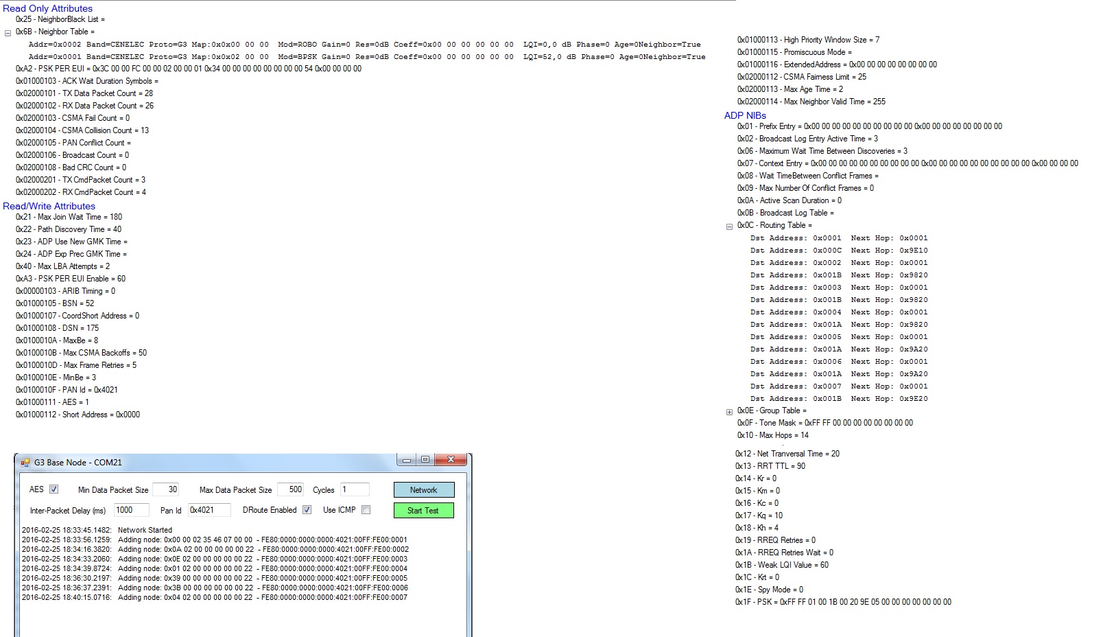

  • Dear Meghana
    i think you must help me since the begin of the configuration of 1 simple net of devices: I build our simple net of devices  with 1 BN and  n.6 SN connected  in series with distance  50 cm each one. When i try to start the net i can see that  only one of the SN ( that i ll name MOM) reach  to connect directly to BN and the others connect to BN passing trought the MOM. If i disconnect the MOM the other SN  disconnect too. If i change  the position of  MOM  in the series the situation doesn't change . All the SN are identical hardware and software. Please tell me : That is the question?
    For you reference i attach a picture with log of Zero Configuration where you can see how work our office test: BN join directly with only 1 SN(Add 0001)  and the other SN   join between one hop with it. If we deattached the 0001  all the SN deattached too!! Repeat that all the device are identical, on the same line and with 30 cm of distance between them. If we add more device SN they will connect all with hop on 0001 SN.

  • hi Alessio ,
    From your observation it seems that as the node used to form the hop in a network MOM is removed the node connected will also be removed .
    Here what is the data transfer happening .. is the DC pinging the nodes ? ideally when the MOM is off the network any further activity to nodes using the MOM will remove the route to the nodes as the entry to the MOM itself would be removed if the MOM is removed from the network and the DC pings to MOM .
    the details on the G3 network behavior can be got from the SPEC ,
    rest of the details can be got in the  TI G3 User Guide-Zero Config GUI.pdf related to the Zero config  gui .
    Regards .
