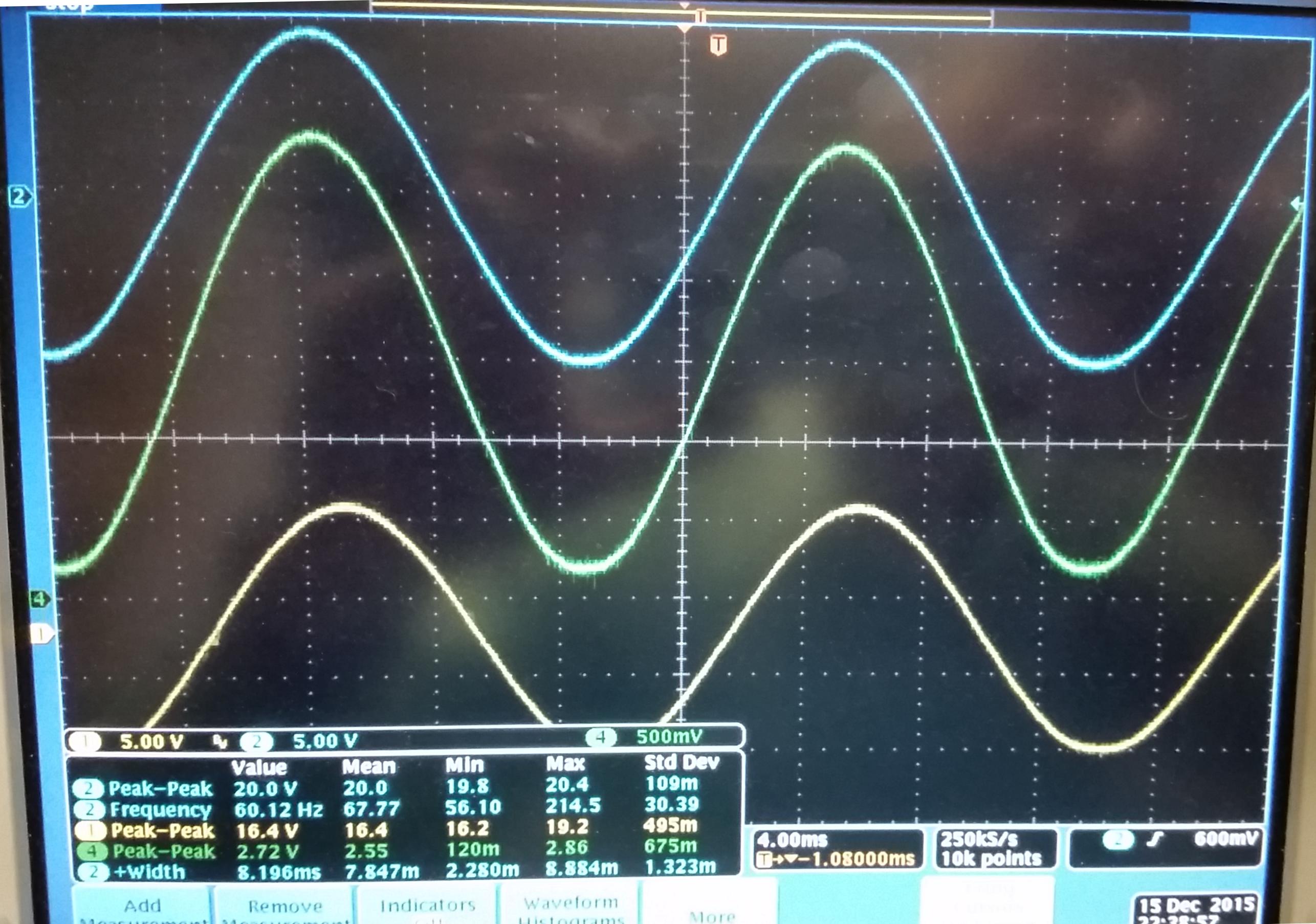

On the pictures below:
The blue trace is bipolar input from signal generator (it gets scaled down and offsetted in conditioning circuit). The green trace is input signal after conditioning: centered at 1.6V. The  yellow trace is what C28 acquires and outputs to the external DAC for diagnostic. The diagnostic signal gets converted back to bipolar signal.
My sample rate is 5 KHz, that's why yellow DAC output trace is delayed.
Any recommendations how to set ADC "more" correctly so it converts all signals?
Small slope:150 Hz frequency, 1.1V  p-p input ADC signal (green) - no distortion
medium slope: 150 Hz frequency, 2.04V  p-p input ADC signal (green)
large slope, 150 Hz frequency, 2.2V  p-p input ADC signal (green)
Here is the proof that it is a slope, not the amplitude of the signal: 60 Hz, 2.7V p-p on ADC input is OK
  • Hi Igor,
    The ADC on this device should work fine with input frequencies into the high 100's of KHz, so lets look at a few things:
    Are you sure the problem is with the ADC samples? Could the problem be with the external DAC, or the SW that is controlling it? - Have you tried sampling a similar signal with the external 16-bit ADC, truncating the results to 12-bits, and then passing it through the same software that you are using to generate the debug waveform on the DAC? Alternately, you could load a simulated fast sine waveform into memory, and then generate that waveform with the DAC. Finally you could capture the Concerto ADC results directly in a buffer, then plot them to confirm that the issue is actually in the ADC sampled data.
    What does the impedance of the signal conditioning circuitry look like to the ADC input? Does it have a LP filter with a high series R? We provide a model of the ADC input in the device DS. You can use spice to simulate the charging of the internal S+H capacitor through your signal conditioning circuitry and the ADC input switch. If the S+H window is long enough, then the S+H capacitor should charge to within 1/2LSB or better during the allocated S+H time. If the window is too short, you can change the ACQPS setting to allow more time. Alternately, you could just increase the ACQPS setting to maximum to see if this helps (and if so, you will want to go back and do the simulations to make sure this makes sense).
  • Hi, Devin,
    What bothers me is the fact that ADC result is depending of the slope of input. I know it looks weird, and trying to get to the root. I did play with
    RE: "Could the problem be with the external DAC, or the SW that is controlling it? - Have you tried sampling a similar signal with the external 16-bit ADC, truncating the results to 12-bits, and then passing it through the same software that you are using to generate the debug waveform on the DAC?"
    We are selling our product for couple of years, and development started 4 years ago. The firmware is pretty refined. The external DAC and ADC work fine, or we would already have some complains. Yes, I have tried putting same signal to external ADC and read it back from the same DAC. We normally dealt with slower changing signals on internal ADC input, but recently we need to acquire faster changing signal and discovered this problem.
    I put sine simultaneously to both internal and external ADC, and internal has distortions. So, I am pretty confident that it is internal ADC setup.
    RE: "What does the impedance of the signal conditioning circuitry look like to the ADC input?"
    We use the standard Concerto card from TI. thus, it has standard TI circuitry. I am aware that some channels on TI card have no anti aliasing filters, but this is observed on any channel.
    I forgot to mention that C28 runs at 150 MHz and M3 at 75 MHz.
    It seems as if there is(are) "sticking" bit(s).  Could it be bus problem?
