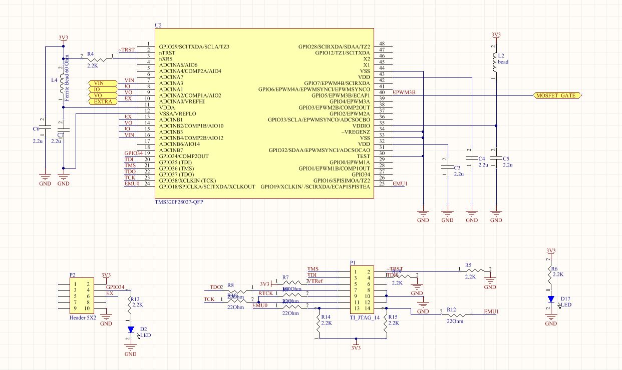

    I have been trying to make a small project using TMS320F28027PTQ DSP. I am trying to program it using TI JTAG14 pin connector.
When I make a new target configuration file, do all proper settings and test the configuration, the connection test succeeds .
Then I build the program and run it, everything goes smooth. and the code runs in emulation mode through code composer studio 6.0.
The problem I am facing is I dont see any output on the desired pins. i.e. I run the sample LED blink program from the examples, and it doesnt work.
I also purchased a Launchpad kit for the same DSP. the code runs just fine on that kit.
So I think there might be some problem with the DSP configuration.
I have attached a picture of the schematics,
I am new to mounting the DSP on board, if someone can help I would really appreciate it.
