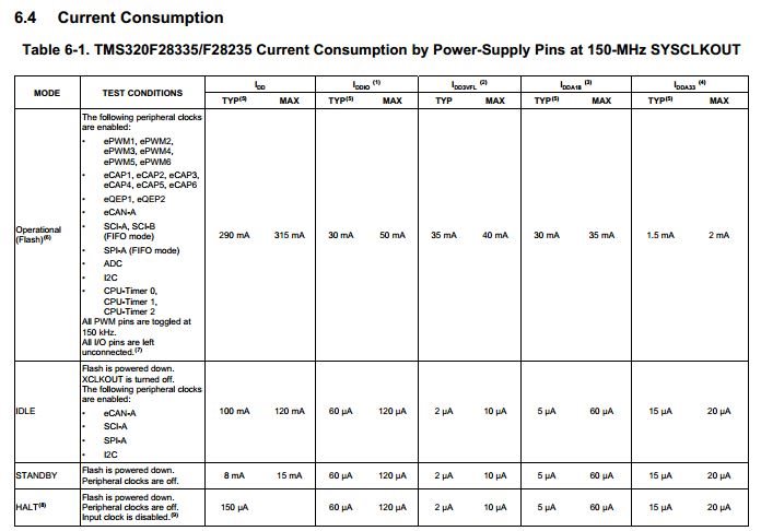

I am designing power supply for control board which uses TMS320F 28335 DSP , I need to know how much current does it draws ! Please help me in deciding this Ic value.
Hi Charles,
You can find the current consumption numbers for this device inside its datasheet.
The datasheet can be found at the below link. The power consumption details will be found in the 'Current Consumption Section'.
http://www.ti.com/product/TMS320F28335
