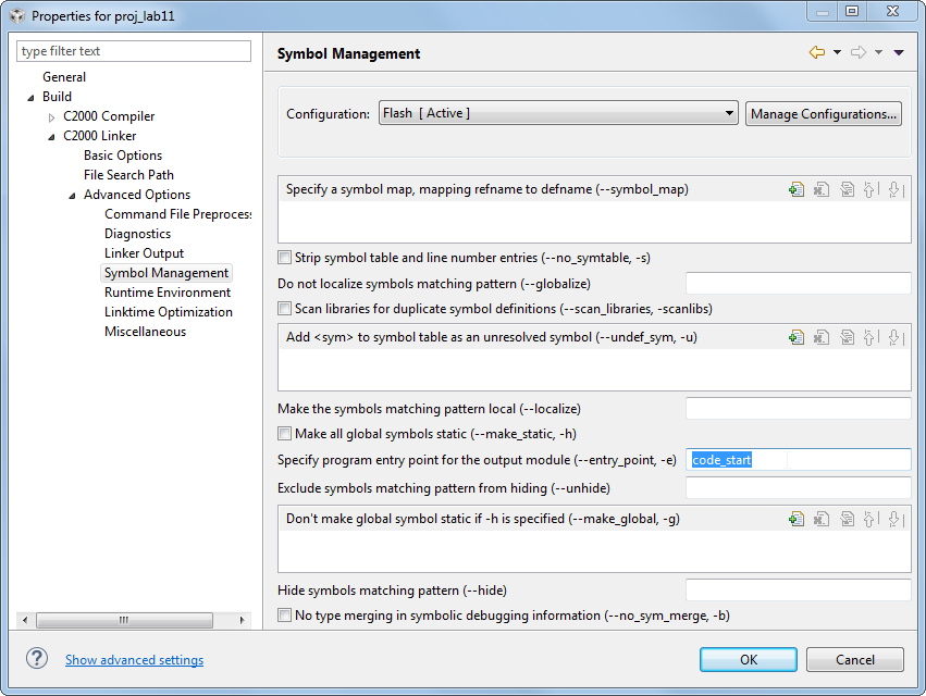

I'm am attempting to modify motorware 115 lab 11 for use in our application.  Everything works like it should however when I attempt to run standalone (no debugger, launchpad switch S1-3 in off position) the motor growls then sometimes the BOOSTXL-DRV8305 faults.  When I download with the debugger everything works as it should.
To isolate the problem I did the following:
Started with a brand new motorware install.
Modified user.h with my motor parameters.
Included gpio.h into proj_lab11.c.
Changed Speed KP/KI to 4.0 and 0.005. - suitable for my motor
Added this snippet at the start of the while(gMotorVars.Flag_enablesys) loop:
        	if(GPIO_read(halHandle->gpioHandle,GPIO_Number_12)==1)
        		gMotorVars.SpeedRef_krpm=_IQ(1.0f);
        		gMotorVars.Flag_Run_Identify=true;
        	else
        		gMotorVars.SpeedRef_krpm=_IQ(0.0f);
        		gMotorVars.Flag_Run_Identify=false;
When running with the debugger, or after a debugger download I can press S3 on the LAUNCHXL-F28027F and the motor will nicely run at 1krpm in response to the button.  At this point I power everything down, move S1-3 to the off position and power up.  Now, in response to pressing S3 the motor will just growl and not run properly.
What is wrong here?  I tried a similar thing with lab10 and it worked properly.

  • I'm thinking there is something wrong with the . CMD file.
    I tagged this for Jeff Stafford to assist.
  • Is FirmwareRev being stored in FLASH or RAM by your linker cmd file?
    http://processors.wiki.ti.com/index.php/C2000_Flash_Common_Issues/FAQs#Code_Does_Not_Run_Standalone

  • the .cmd files seems to be the same as for lab10, but maybe it needs to be different.
    I don't know where FirmwareRev is being stored. Maybe it is in RAM that is not being loaded. With the arm tools I am familiar with making it const puts it into flash. However I removed the const attribute and it now works as expected. What is the proper way to make this store into flash and allow me read only access?
    I also confirmed the lab11 issue occurs using the LAUNCHXL-F28027F and BOOSTXL-DRV8301.
  • Just to clarify, when I said "works as expected" I mean that strlen(FirmwareRev) is correct, but the motor still fails to run properly.
    I repeated this test with lab10. It works fine with and without the const attribute. This is further evidence that something is up with the linker.
  • Hi Dr Proton,
    Please send your linker CMD file with a TXT extension and also your MAP file. I will review both and comment.
    1. Just to confirm, are you able to run the other labs from flash and lab11 is the only lab that does not run from flash?
    2. Did lab11 run from flash prior to code modifications?
    Jeff
  • Jeff,
    The linker command is the one included in the project by default, but I will attach it just the same.  I'll attach the .map from the project with minimal edits as well.
    I have only tried lab10, but it worked just fine.  lab11a did not.
    lab11 did NOT run properly prior or following my modifications.  As a test I took a clean install of motorware and made the minimum possible changes to get the motor running without the debugger.  See my original post.

  • I figured it out. I had added a couple pointers to the HAL_obj struct so I needed to bump the size of 0x1C6. The error I was given was not particularly clear on this. With this modification made everything works as it should.
  • OK we found the root cause. It is related to when the .econst section is moved to RAM. This section is moved inside of main(), although functions prior to main() need .econst values to be available in RAM already, so we need to move that conde to code_start. So there are a few changes.
    1. Change entry point of the project to code_start. This can be done in the project properties:
    2. Create a function that moves .econst and .switch to RAM, and remove the code that does that in main. So use the attached example:

    3. Modify your codestartbranch.asm file, as per attached, so it moves .econst and .switch before _c_int00. You can find that file in: C:\ti\motorware\motorware_1_01_00_15\sw\drivers\cpu\src\32b\f28x\f2802x\CodeStartBranch.asm
    2728.CodeStartBranch.asm
    Give this a try. I will log this issue so we fix it for next release.
    -Jorge
  • Took some fiddling but I managed to make my project take a unique CodeStartBranch file. Now it works as expected. I'm glad I've been able to find this (and other) problems in motorware but I'm worried about how many are still left...
