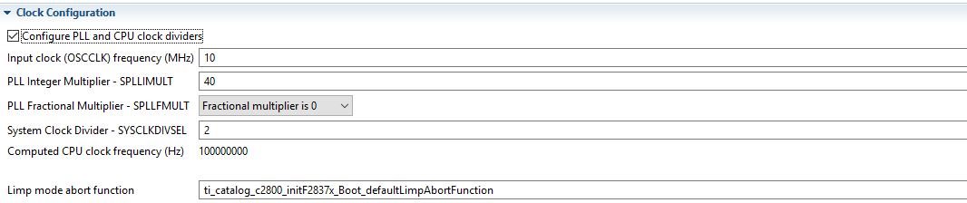

  • Thank you for your quick response - follow up question:
    When using RTOS with the same suggested configuration as above,
    But by my math we should get 200MHz.  This wouldn't be an issue unless the BIOS wasn't trying to enforce a CPU freq in the runtime config.  Thoughts?
