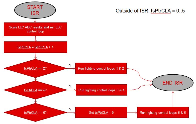

Question1:
Please give me a detailed explanation of the role of variable tsPtrCLA?

  • Hi Andrei,
    1) tsPtrCLA is used to time slice the ISR so that only certain tasks are run each ISR - the LLC control loop should run every ISR, each LED control loop only runs 1:6 ISRs.  This was done because it was decided that the LED lighting power stages did not require as much control bandwidth.
    Because the PWM update macro always contains the PWM updates for two control loops, we chose not to further separate the tasks.
    See below for a rough flowchart.

  • Hello Brett,
    Flow chart completly answer my 1st question.
