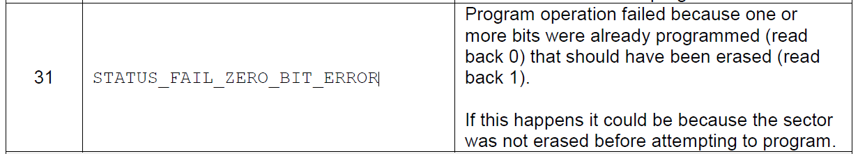

Programming...  failed (write error: 31 @ 3f6000)!

  • Hussain,
    Flash error: 31 is described below.
    In short, it means we can't program 1 because that location has already been programmed as zero. For example, if you program a location with 0x0001 and then try to program the same location with 0x0002 the function will return this failure.
    Manoj
