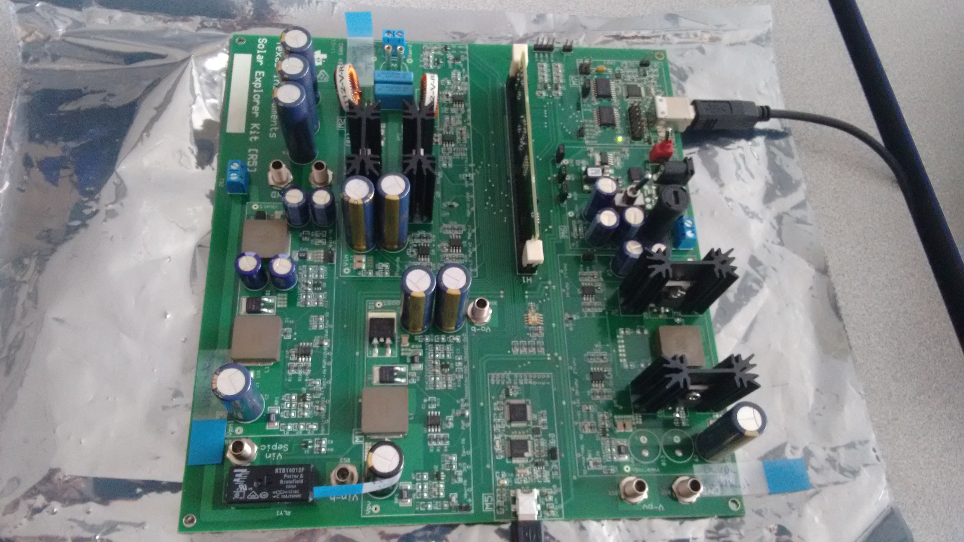

I have the C2000 Microcontrollers Solar Explorer Kit part #: TMDSSOLARPEXPKIT
I am using Code Composer Studio Version: 6.1.1.00022
I have used the GUI example in ControlSuite before and it worked fine but for some reason I cannot operate it any longer. I noticed that the LED M5 LD2 is on but not flashing as it used to. I also get an error message when I try to upload code onto the board. This error message says that the controller is locked and needs to be unlocked either by resetting or by using a password.

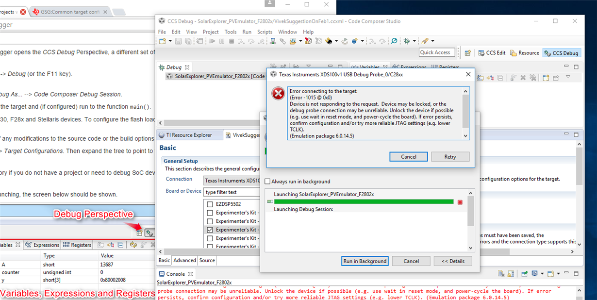

    By the way, here's the exact error message that I am getting when I try to upload code onto the chip:
    C28xx: Error connecting to the target: (Error -1015 @ 0x0) Device is not responding to the request.  Device may be locked, or the debug probe connection may be unreliable. Unlock the device if possible (e.g. use wait in reset mode, and power-cycle the board). If error persists, confirm configuration and/or try more reliable JTAG settings (e.g. lower TCLK). (Emulation package 6.0.14.5)

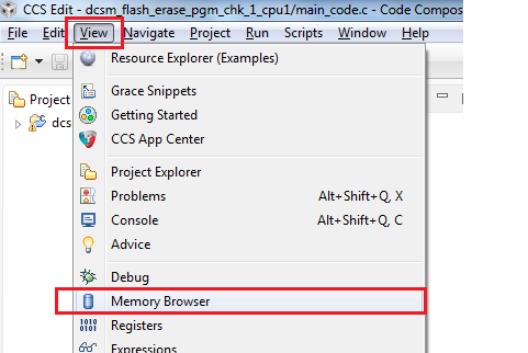

  • Hi Ahmed,
    These are values for KEYx register which user provides via CCS Flash-plugin GUI. What I was referring was to see the content of CSM password locations in Flash via CCS memory browser window.  To open memory browser in CCS, click on "View -> Memory Browser" in CCS GUI and this will open the memory browser window where you can enter any address to check the content.
    Address for CSM password location in Flash are (0x3F 7FF8 - 0x3F 7FFF). Please check the value at these address and these are not 0xFFFF_FFFF then device is LOCK. It could have happened by some wrong flash programming operation or power loss during flash operation.

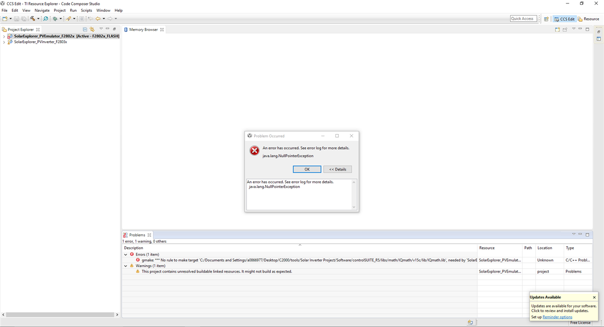

    I was trying to do what you said but when I click on 'Memory Browser' I get the error message in the attached pic.
    I searched the error message online and I got an answer in the following link but I am not sure how it is relevant to our problem.
    Link: stackoverflow.com/.../what-is-a-null-pointer-exception-and-how-do-i-fix-it

  • Ahmed,
    That is strange. It should not give any error. Did you try restarting CCS to see if that helps.
    You may also want to go through following link to get some help on CCS debug -
    http://processors.wiki.ti.com/index.php/GSG:Debugging_projects_v5#Launching_the_debugger

    I tried to go through the debug process shown in the link you provided, but I was unable to complete the it as whenever I try to run the debug I get the errors shown in the attached images. When the error in the first image appeared I clicked "Proceed", then the error in the second image appears. I also ran the Connection Test and the results of the test are pasted after the images.
    You mentioned that you will be asking someone from marketing regarding the replacement. Were you able to ask them? Please let me know.
    P.S: In the target configuration, I set up the target as the "Experimenter's Kit - Piccolo F28027" and the connection I chose was "Texas Instruments XDS100v1 USB Debug Probe".
