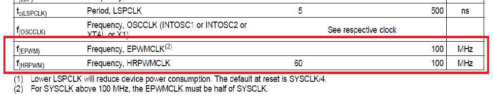

I am currently playing with the F28377S launchpad, and I am quite amazed so far. However, I am struggling with adapting my ideas into the code. In particular, I use controlsuite and its example "epwm_deadband". And I can adjust the duty cycles of my PWM channels according to what I want. However, I cannot manage to change the PWM frequency according to my calculations. The Technical Reference Manual says for Up-Down-Count mode:
T_PWM = 2*TPRD*TBCLK
I assume a processor clock frequency of 200MHz, and I would like to have a 16kHz PWM. Thus, the value for TPRD should be
TPRD = T_PWM/(2*TBCLK)=f_CLK/(2*f_PWM)=200MHz/(2*16kHz)=6250
I am measuring the pins on ePWM2A and ePWM2B, which have the PRD assigned to 6250 with a duty cycle of 50% (i.e. PRD/2). On the oscilloscope, I do measure a duty cycle of 50%, exactly as wished. However, the frequency of my PWM signal is 4kHz instead of 16kHz - which is a factor of 4 smaller meaning that my microcontroller is running at 50MHz instead of 200MHz.
According to my best knowledge, the code as posted below should result in a PWM frequency of 16kHz when PRD is set to 6250, which means that the clock frequency is scaled down somewhere else.
But I cannot figure out where I have the option to scale my clock frequency. Could you maybe assist me with that?
Thank you.

  • Hi Zander,
    Check this file: F2837xS_SysCtrl.c
    Gautam
  • Hey,
    thank you very much for your quick answer. I did go through the file F2837xS_SysCtrl.c but it is more confusing than explaining to me :)
    In that particular file, the function InitSysCtrl(void) is as posted below where the PLL is defined. I did the debugging by setting a breakpoint. And as it seems, this is what I get:
     InitSysPll(XTAL_OSC,IMULT_20,FMULT_0,PLLCLK_BY_2); 		//PLLSYSCLK = (XTAL_OSC) * (IMULT + FMULT) / (PLLSYSCLKDIV)
    If I do the calculation according to
    XTAL_OSC*(IMULT+FMULT)/PLLsysCLKdiv, I will get:
    1*(20+0)/1 = 20
    What does this tell me?

  • Good evening gentlemen,
    I've spent several hours trying to understand and debug the code in the F2837xS_SysCtrl.c file. I've set a breakpoint in this if-else-cause:
    #ifdef _LAUNCHXL_F28377S
        InitSysPll(XTAL_OSC,IMULT_40,FMULT_0,PLLCLK_BY_2); 		//PLLSYSCLK = (XTAL_OSC) * (IMULT + FMULT) / (PLLSYSCLKDIV)
    #else
    #endif
    Apparently, it is always the second option that applies. Am I right that this is the line of code that I need to change in order to change the clock frequency of my F28377S? Or am I at the wrong part of the code here?
    Looking forward to hearing from you.
    BR,
    Alexander
  • Hello again,
    I am very unhappy and disappointed about the experience with the F28377S evaluation board. While I do believe that it is a powerful microcontroller unit and very attractive for digital control applications, it is not easy to follow and modify the example codes. In particular, I do not understand why my PWM frequency does not match with my calculations according to the datasheet, which means, there is a setting somewhere that I am unable to find. I am still working on the epwm_deadband example from controlsuite, which I slightly modified. In the F2837xS_SysCtrl.c file, I define my PLL to be 200MHz (INT_OSC2*IMULT_40/PLLCLK_by_2) which gives me a PLLRAWCLK of 400MHz and thus a CPU frequency of 200MHz. According to the up-down count mode in the ePWM channel, I should expect a 16kHz PWM signal if I set PRD=6250:
    f_pwm = f_osc/(2*TBPRD) = 200MHz/(2*6250)=16kHz
    But effectively, I get a PWM of 7kHz, which is way below the target, and I do not understand why. I would appreciate if one of you would be willing to help me. By now, I actually believe that the error is not the CPU frequency anymore, but rather a scaling somewhere related to the PWM channel. The code from the epwm_deadband.c file as well as the F2837xS.c file are posted below as well as a screenshot of the oscilloscope picture:

  • Hi Alexander,
    On this device the maximum operating frq for ePWM module is 100 MHz. So even though CPU is running at 200MHz, the ePWM frq is 100 MHz and that is why you see 1/2 the value.
    This information is captured in datasheet as well as TRM.
    In TRM see the "Figure 2-5. Clocking System" which should the clock divider for PWM. This clock divider is controlled by "EPWMCLKDIV" field of
    PERCLKDIVSEL register (detail given in Figure 2-151. PERCLKDIVSEL Register).
    In datasheet "Table 5-12. Internal Clock Frequencies" has this information captured.
     Hope this clarifies the issue.
    Vivek Singh
  • There is an additional EPWM clock divider, which, by default is is SYSCLK/2. ClkCfgRegs.PerCLKDIVSEL.EPWMCLKDIV. You can verify your SYSCLK by enabling XCLKOUT.
    I am not sure of the top of my head if the on board oscillator of the Launchpad is a 10MHz or 20MHz. you will want to verify that as well by checking out the Launchpad schematics.
    Refer to the Clocking section of the System Control Chapter of the F2837xS TRM for more information on the clocking schemes of this device.
    -Mark
  • Hello Vivek and Mark,
    I sincerely thank you for your quick reply and your help. It is working perfectly fine now and this particular issue is solved. In fact, two things caused the issue:
    1. the external oscillator on the Launchpad connected to the XTAL pins of the microcontroller is running at 10MHz (and not wrongly assumed to be 15MHz) whereas the example in the TRM uses 15MHz. Unfortunately, I relied on the example in the TRM rather than checking out the Launchpad schematics.
    2. I finally figured out on how to change the EPWMCLKDIV to the proper value.
    With these two things, I now get the PWM to be consistent with the formula from the TRM.
    You guys really saved my weekend.
    All the best,
    Alex
