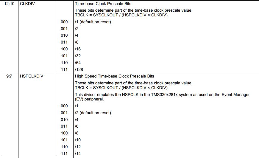

  is it possible to divide CLKDIV and HSPCLKDIV by 8,16 etc.....when we use 8 and 16...we are getting an error like CLKDIV 8 IS UNIDENTIFIED..
FOR A 150 MHZ SYSCLOUT PROCESSOR,FOR HAVING TPWM=0.0008 SEC,WHAT IS THE TBPRD needed...
provieded CLKDIV AND HSPCLKDIV=4,tbclk=1/(150e6*4*4) and  TPWM=2*TBPRD*TBCLK
is it..3752.3?
