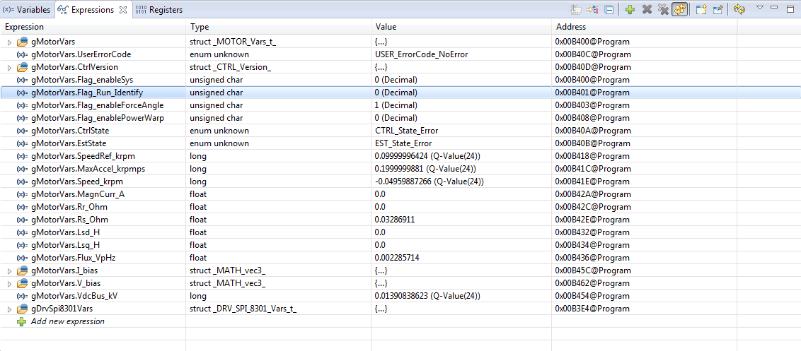

I've been using lab02c to identify a low inductance PM motor, and I'm experiencing some issues with the lab. Approximately 2 out of 3 attempts to ID the motor, the motor will only "wiggle", i.e turn about 5 degrees, then reverse. It occasionally works as intended, and will react to changes in SpeedRef correctly.
Also, the Lsd & Lsq values vary widely; last instance, they've been hovering around 5uH, but will change to ~2nH once motor ID completes. Any idea what's causing this? I would expect an inductance in the micro range, not nano.

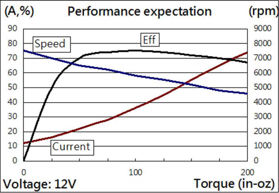

    I'm using the DRV8301-69M-EVM with a Vin = 16V. My motor curve is included below:

    Is this a hobby motor? Any link to any data on it? 7500 RPM with 4 poles is a bit abnormal. Most hobby and low inductance motors have much higher rated frequency than 250 Hz. Also, in the first post you had a maximum current for the motor of (3.0) yet in the second you use (8.0) just for the RES_EST_CURRENT. Do you have a spec on the rated voltage and current of this motor?

    It is not a hobby motor but unfortunately there is not "standard" nameplate data available.  The only data I have is the curve that Sean shared above.  I drove the motor at 1000 RPM and there are 2 electrical periods per revolution.  Period of 1 electrical phase = 30ms and 1 revolution = 60ms, so 2 periods per revolution.  How many poles is that?  If we assume 6000 RPM is rated speed the revolution period would be 10ms so one electrical period would be 5ms (200Hz).  Maybe I am incorrect on this thought...
    When ID starts and EstState is RoverL, there is no value for .Rs_Ohm.  Just after EstState goes from  RoverL to Rs, then Rs_Ohm begins updating.  It eventually arrives at 16-18mΩ.  I measured the R line to line to be 32mΩ, so Rs = 16mΩ makes sense for Rline-neutral.

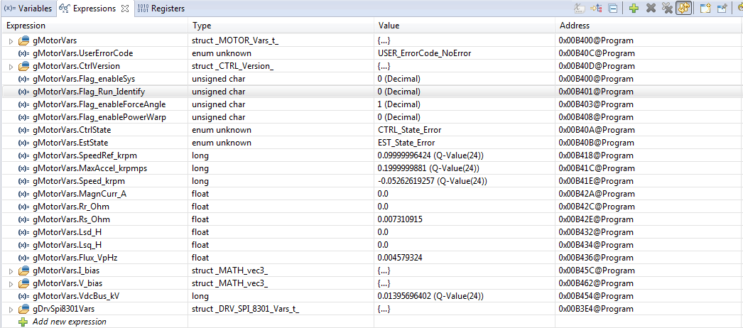

    I tried your parameters for each motor and bothhad the same result, didn't identify and state error.  My power supply is large enough, 110 amps.  Attached are the "results".

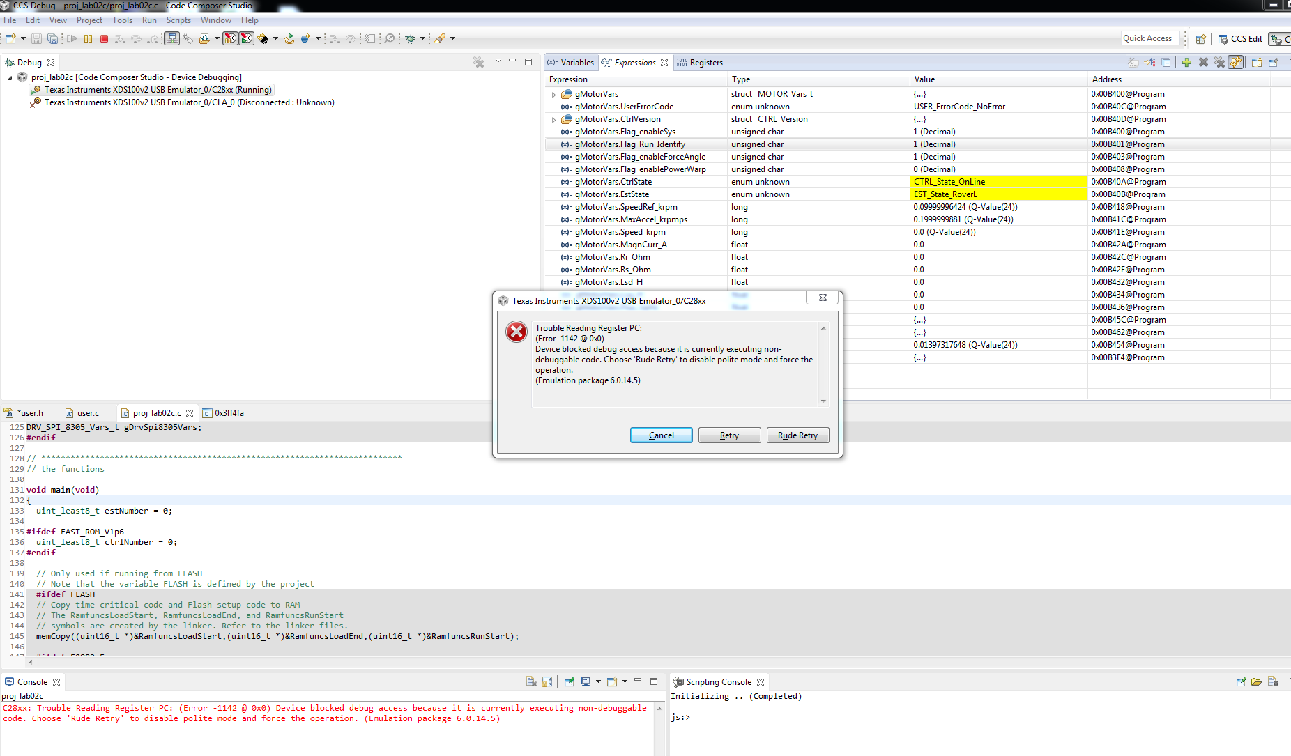

    Every time I try to ID the motor I get the following error.  I cycled the power and this error comes up every time now.  Do you know what can cause this?  I got this error every once in a while before I changed the resistors.

    the error looks like what happens when you try to connect to a target which is already debugging code in real-time mode. when you first connect you are able to load the project, enter real-time, run, and enable the system?

    the error looks like what happens when you try to connect to a target which is already debugging code in real-time mode. when you first connect you are able to load the project, enter real-time, run, and enable the system?  The error occurs shortly after I start the ID'n by changing gMotorVars.Flag_Run_Identify from 0 to 1.  It happens when the motor is first energized (at least audibly).
    With the above changes, the error no longer occurs, but the motor will not ID, Lsd_H and Lsq_H are 5.018264e-13 and the motor does not run up.  I didn't change the current feedback hardware.  To be clear I am not using the motor that you have (that is my only one) I am using a hobby RC  motor 3974-2200KV.

    Also, I changed R60, R61, and R63 to 17.8k to better scale the phase voltage measurement.  I also changed:
    USER_IQ_FULL_SCALE_VOLTAGE_V      (15)
    USER_ADC_FULL_SCALE_VOLTAGE_V       (15.07)
    USER_VOLTAGE_FILTER_POLE_Hz  (408)
    These changes improved the max torque I measured on the dyno and it took lees rotational input from me to get past startup, it was a marked improvement.  I have attached the user.h with the changes above.2337.user.h
    Start up torque needs to be improved and I have read on this forum that hall effects will improve this because position is better known.  My motor has sensors (60 degree spacing) and my EVM can accommodate hall sensors (J10).  Is there an improved lab over lab11e that shows how to do this?  At what current level will I need to rescale the current sensors (voltage divider and ADC)?
