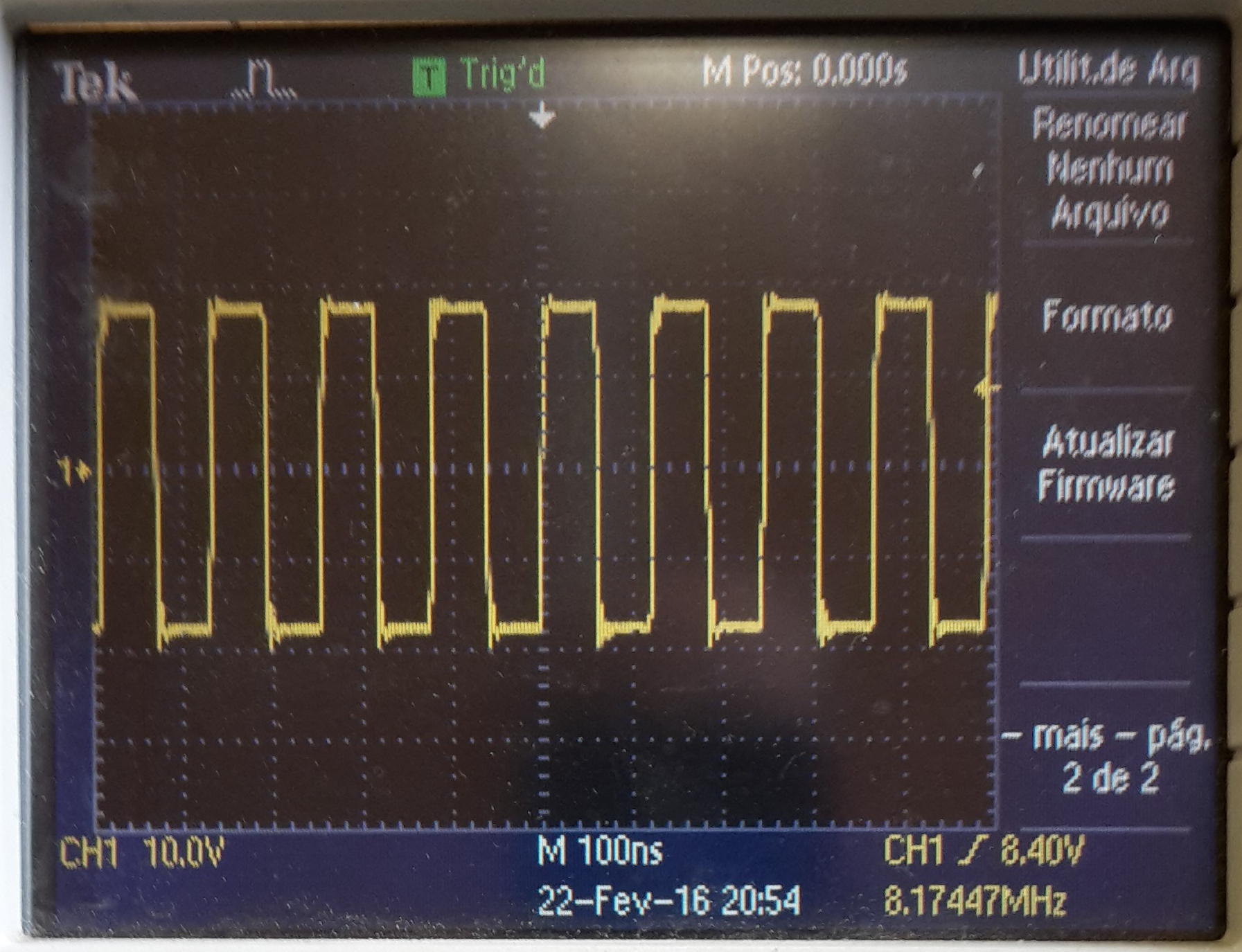

    To understand what is going on, I've used the XCLKOUT feature of the DSP and tested de systems frequency using the XCLKOUTSEL bit.
    For my DSP PLLSYSCLK I've got 25 MHz, witch is expected. I'm running at 200 MHz (with a external ocilator of 20 MHz) and the XCLKOUTDIVSEL was set for 1/8.
    This means that 25 MHz = 200 MHz / 8
    So far so good.
    But when I tested the INTOSC1 (reference for the watchdog timer), I got 8.17 MHz instead of 10 MHz.
    For this test I set the XCLKOUTDIVSEL for 1/1.
    I'm sending a screenshot for you to see.
    You can see the INTOSC1 frequency in the bottom right corner of the picture.
    This frequency explains my time drift for the watchdog timer.
    Is there a way to adjust the internal Oscilator to get the correct 10 Mhz frequency?
    My best regards, Jorge

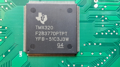

  • Hi Jorge,
    Can you provide the information mention on the top of the device (you could take a pic and attach) to know which version of device you are using.

    I've made the same test to another 2 dsp that I have and got different values: 9,46 MHz for both, instead of 10 MHz.
    The picture of the top of my dsp is this:
  • Hello again Vivek,
    Do you have any information about this issue?
    I'm getting internal oscillator frequencies bellow the 5% average admited (from 9.7 Mhz to 10.3 Mhz).
    Is possible that the adjust values from the internal oscillator were change (by memory corruption, for example)?

  • Hello Jorge,
    For TMX devices the internal oscillator may not be trimmed. Please see p. 9 of the silicon errata document re: internal oscillator. www.ti.com/.../sprz412f.pdf
    Please let me know if you further clarification re: the oscillator.
