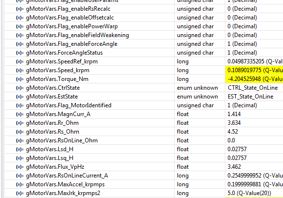

The problem I am having is force angle seems to be active above speeds where it should be applied.
User.h has:
#define USER_ZEROSPEEDLIMIT      (1.0 / USER_IQ_FULL_SCALE_FREQ_Hz)     //  1Hz = 30 RPM
#define USER_FORCE_ANGLE_FREQ_Hz   (2.0 * USER_ZEROSPEEDLIMIT * USER_IQ_FULL_SCALE_FREQ_Hz)    // 2Hz = 60 RPM
First screen shot: With Force Angle enabled and a speed reference of 50 RPM, the Force Angle algorithm stays on and the motor rotates at 60 RPM (measured with a separate encoder), and the FAST estimate of the speed Speed_krpm is 100 RPM.    See first screen shot.    The indicated torque is negative.

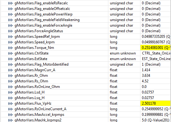

Second screen shot:   With Force Angle disabled the motor runs correctly at 50 RPM.
If I understand correctly force angle should never be active above the zero speed limit.  Why does force angle stay on when the motor speed is 60 RPM and the zero speed limit is 30 RPM?
Why with force angle disabled can the FAST algorithm determine the speed correctly at 50 RPM (and even lower speeds in my tests), but when force angle is enabled the FAST speed indication is 100 RPM but the motor is actually at 60 RPM?

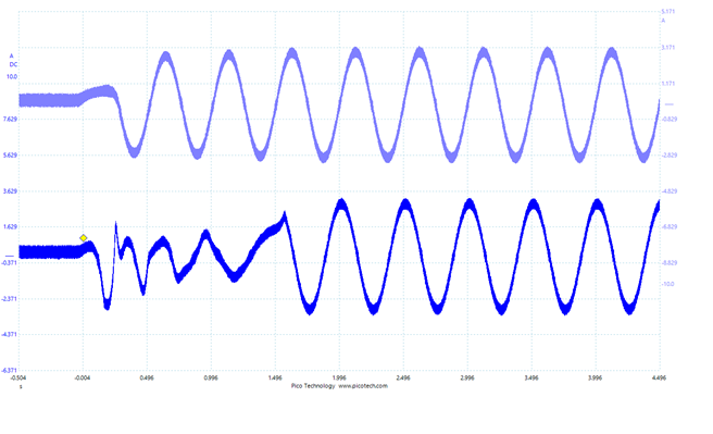

    Below are current waveforms for 50 RPM and 10 RPM startups.   In both cases force angle becomes active, but for the 50 RPM startup (bottom) you can see force angle doesn’t immediate come on.  At first the current waveform is distorted, then force angle comes on.   This is the waveform corresponding to my first debugger window post that shows FAST estimates the speed at 100 RPM, but the motor stays running at the force angle indefinitely.  The 10 RPM startup waveform (top) immediately starts with force angle active.
    Why does the 50 RPM startup not immediate use force angle like the 10 RPM startup?

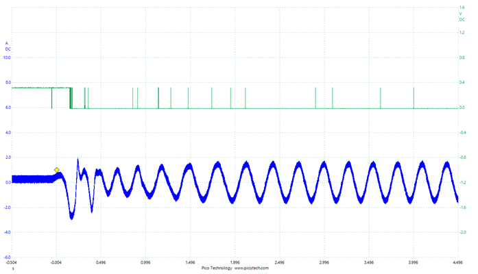

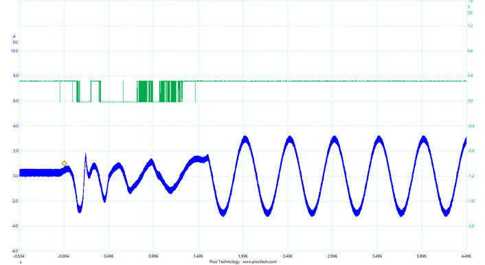

  • I added a hardware output indicating when force angle is active.   For a 50 RPM startup force angle starts off on (as maybe you suspected) but then toggles off/on for a while, at some points very quickly, and then goes to steady on.  Green is high when the force angle status indicates on.  The first short pulse low (around t=-.004) is when the controller goes online where the hardware output line is initialized low.
    50 RPM startup with force angle status:
    Below is a 100 RPM startup.   The force angle status pulses on for short periods indefinitely after startup even though the motor is running good at 100 RPM:
    For 50 RPM, what changes within FAST such that force angle pulses on/off in the beginning, but then latches on?
    For 100 RPM, the motor is running good at 100 RPM and a tach shows only about a +/- 2 RPM bobble, why does force angle pulse on for very short periods of time?    ZEROSPEEDLIMIT is set to 30 RPM.   Does this indicate that within FAST the speed indication is instantaneous going below 30 RPM so FAST is turning force angle to active?   At 100 RPM I would think FAST should be pretty well locked on to the rotation.

  • at 50 RPM (1.66 Hz) I can see FAST giving some estimates below the 1 Hz limit you are using. That one doesn't surprise me.

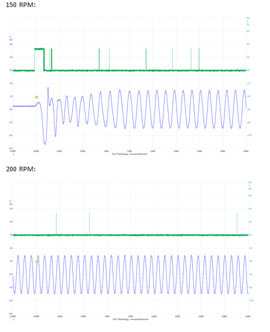

  • See below screen shots for 150 & 200 RPM.  At 150 RPM force angle still comes on fairly often.  At 200 RPM once in awhile.   At 300 RPM it stays inactive.
    It seems like FAST is false triggering to turn force angle back on?
    But on startup it seems like FAST is too quick to deactivate force angle.   FAST deactivates force angle and then the speed overshoots before settling and regulating at the reference speed.   For example a 100 RPM startup overshoots initially to 150 RPM before settling.
