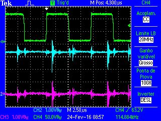

TZFRC PROBLEM WITH TBCTL.bit.PRDLD LOADED BY SHADOW REGISTER
Dear Supplier,
My application is a switching power converter and i'm using TMS320F28035PAGT to control a half-bridge LLC converter and a synchronous rectifier.
EPWM3A and EPWM3B drive the half-bridge power MOSFETs.
EPWM4A and EPWM4B drive the synchronous rectifier MOSFETs.
When using imemediate load for the PRDLD register it works fine:
(*ePWM[4]).TBCTL.bit.PRDLD = TB_IMMEDIATE;
When using shadow register load for the PRDLD register it shows the problem described below:
(*ePWM[4]).TBCTL.bit.PRDLD =  TB_SHADOW

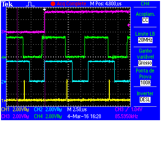

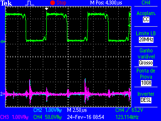

A) EPWM4 TRIPZONE OST CAN BE ACTIVATED AND CLEARED SUCESSIVELY WITHOUT ANY PROBLEM
GREEN - EPWM3A / CYAN - EPWM4B / MAGENTA - EPWM4A

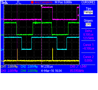

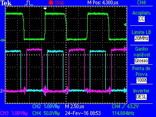

B) WHEN EPWM3 AND EPWM4 TRIPZONE OST ARE ACTIVATED BOTH OPERATES CORRECTLY

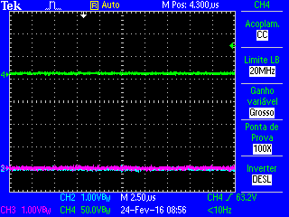

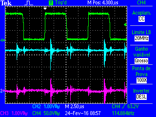

C) WHEN EPWM3 AND EPWM4 TRIPZONE OST ARE CLEARED EPWM3 RETURNS OPERATING CORRECTLY BUT EPWM4A AND EPWM4B DO NOT RETURN TO PWM OPERATION.
EPWM4A STAYS AT LOW LEVEL AND EPWM4B STAYS HIGH LEVEL
What can be the cause of this wrong behavior?
How to avoid such behavior using shadow mode for  EPWM4 PRDLD

    Can you also share the trip zone register configuration?
    1. What is the status of one shot trip flag for EPWM4 (in TZFLG register)? Does it get cleared?
    2. Can you disable phase loading for PWM4 and check the behavior?
    (*ePWM[4]).TBCTL.bit.PHSEN = TB_DISABLE;
    -Bharathi.
  • Dear Bharathi
    First of all thanks for the support.
    EALLOW;
    EPwm4Regs.TZSEL.bit.OSHT3 = 1; //
    EPwm4Regs.TZCTL.bit.TZA = 2; //
    EPwm4Regs.TZCTL.bit.TZB = 2; //
    EPwm4Regs.TZFRC.bit.OST = 1; //
    EDIS;
    EALLOW;
    EPwm3Regs.TZSEL.bit.OSHT1 = 1; //
    EPwm3Regs.TZCTL.bit.TZA = 1; //
    EPwm3Regs.TZCTL.bit.TZB = 1; //
    EPwm3Regs.TZFRC.bit.OST = 1; //
    EDIS;
    Yes, it is clear when the problem happens.
    Using the code below it works correctly.
    I included EPwm4Regs.TBCTL.bit.PHSEN = 0 after EPwm4Regs.TZFRC.bit.OST=1
    EALLOW;
    EPwm4Regs.TZFRC.bit.OST=1; // Habilita shutdown
    EDIS;
    EPwm4Regs.DBRED = 750;//150; // GARANTE DUTY CYCLE = 0 ANTES DE LIMPAR FLAG TZCLR
    EPwm4Regs.DBFED = 750;//150; // O DUTY CYCLE SERA LIBERADO PELO CLA NO MODO PFM
    EPwm4Regs.TBCTL.bit.PHSEN = 0;
    I included EPwm4Regs.TBCTL.bit.PHSEN = 1before EPwm4Regs.TZCLR.bit.OST=1
    EPwm4Regs.DBRED = 750;//150 // GARANTE DUTY CYCLE = 0 ANTES DE LIMPAR FLAG TZCLR
    EPwm4Regs.TBCTL.bit.PHSEN = 1;
    EALLOW;
    EPwm4Regs.TZCLR.bit.OST=1; // LIMPA FLAG TZCLR
    EDIS;
    Could you help me to understand how the problem happens?

  • Hi Ricardo,
    OK. This kind of confirms what I was suspecting would be the issue. Few notes -
    - It is possible that the issue could happen in Immediate mode also, it just depends on when you are making updates to TBPRD and the the value of phase you are loading.
    - When you choose shadow ((*ePWM[n]).TBCTL.bit.PRDLD = TB_SHADOW;) loading of new value into the TBPRD happens at the next counter zero.
    - I believe, You are running in to a boundary condition where the new TBPRD value is not loaded in to EPWM4, because counter zero did not occur for EPWM4 due to phase loading. That's the reason I asked you to disable the phase loading and check the behavior and your results confirm the same.
    - So you need to make sure the value of phase being loaded, status of the EPWM4 time base counter etc are proper and counter would proceed to zero and new TBPRD value takes effect.
    - If the Counter of EPWM4 never reaches to zero - new period value will not be loaded and the counter may continue to keep counting and no PWM output will be generated during those cycles.
    -Bharathi.

  • Dear Barathi,
    I observed a relation between the way PWM is started after a TZFRC and the wrong behavior of EPWM4 operating with PHSEN enabled in shadow mode.
    I would like to receive your comments about the tests shown below.
    Case 1) Problem with epwm4 after TZCLR.bit.OST
    (*ePWM[4]).TBCTL.bit.PHSEN = TB_ENABLE;
    (*ePWM[4]).TBCTL.bit.PRDLD = TB_SHADOW;
    EPwm4Regs.TBPHS.half.TBPHS = 1
    I set a fixed and small value (1) for EPWM4 TBPHS ;
    I remove the code where TBPHS was being updated in real time.
    my routine to stop EPWM4
       EALLOW;
       EDIS;
    my routine to start EPWM4
               EALLOW;
         EDIS;
       EALLOW;
       EDIS;
    FIGURE LEGEND:
    YELLOW - EPWMSYNCO
    CYAN - THE LOW STATE IS THE PERIOD WHERE THE REAL TIME CALCULATIONS AND PWM UPDATES HAPPENS
    GREEN - EPWM3B (ACTIVE LOW)
    MAGENTA - EPWM4B (ACTIVE HIGH)
    Case 2) The problem does not happen in this case.
    I changed the start routine
    first i set TZFRC.bit.CBC and after that i clear TZCLR.bit.OST
    my new routine to start EPWM4
           EALLOW;
           EPwm4Regs.TZFRC.bit.CBC=1;
         EDIS;
    FIGURE LEGEND:
    YELLOW - EPWMSYNCO
  • Hi Ricardo,
    i think this is expected behavior.
    In case 2 where you are forcing CBC event - the clear of CBC event would result in PWM being resumed at next counter zero. This would also mean that new period and phase value would be loaded into the counter as expected.
    In case 1 when you are forcing OST event - when you clear the trip action the PWM would resume operation immediately - not waiting for a counter zero event. This could possibly result in erroneous behavior depending on when in s/w w.r.t. PWM state you are clearing the flags.
    -Bharathi.
