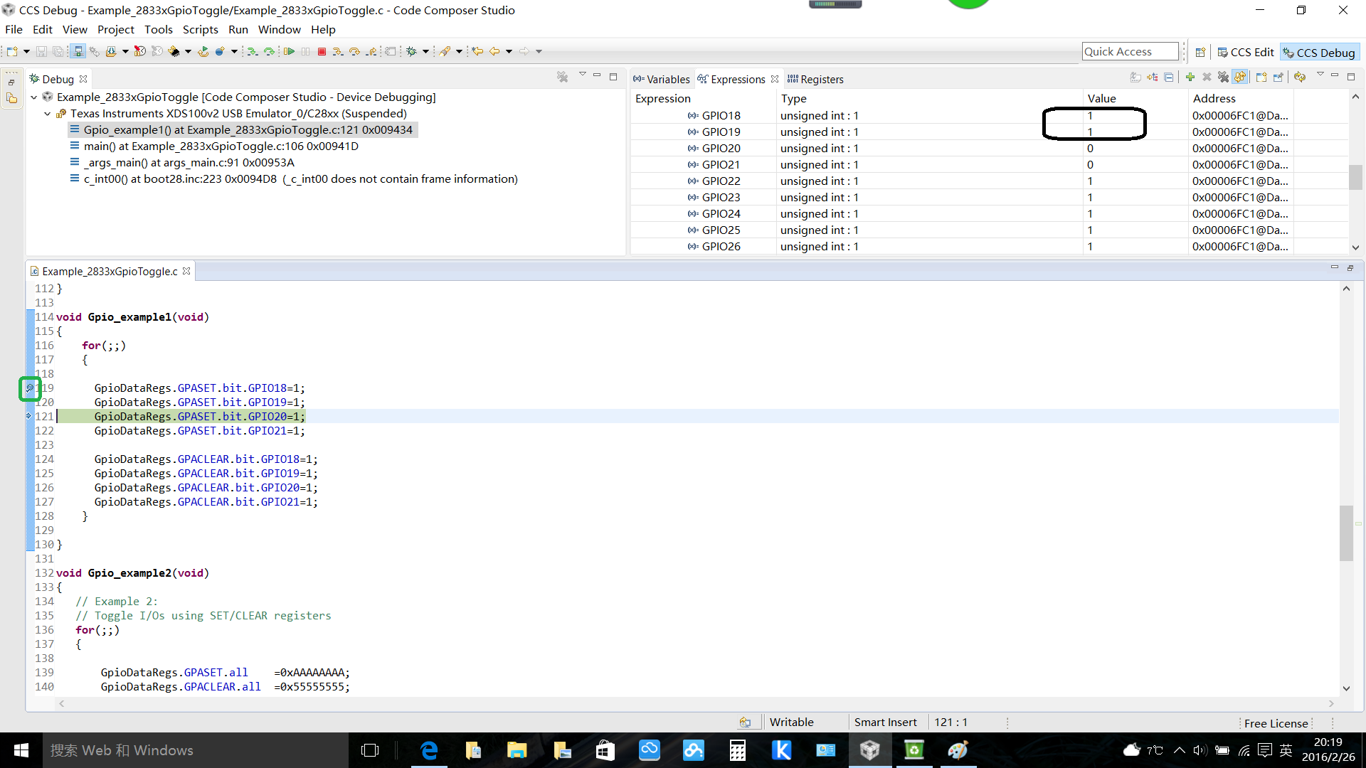

GPASET GPACLEAR is Not work well
Firstly, the following configuration:
EALLOW;
   /************扫描口***************************/
    GpioCtrlRegs.GPAMUX2.bit.GPIO18 = 0;//功能普通gpio
    GpioCtrlRegs.GPAMUX2.bit.GPIO19 = 0;
    GpioCtrlRegs.GPAMUX2.bit.GPIO20 = 0;
    GpioCtrlRegs.GPAMUX2.bit.GPIO21 = 0;
    GpioCtrlRegs.GPADIR.bit.GPIO18=1;//输出
    GpioCtrlRegs.GPADIR.bit.GPIO19=1;
    GpioCtrlRegs.GPADIR.bit.GPIO20=1;
    GpioCtrlRegs.GPADIR.bit.GPIO21=1;
   EDIS;

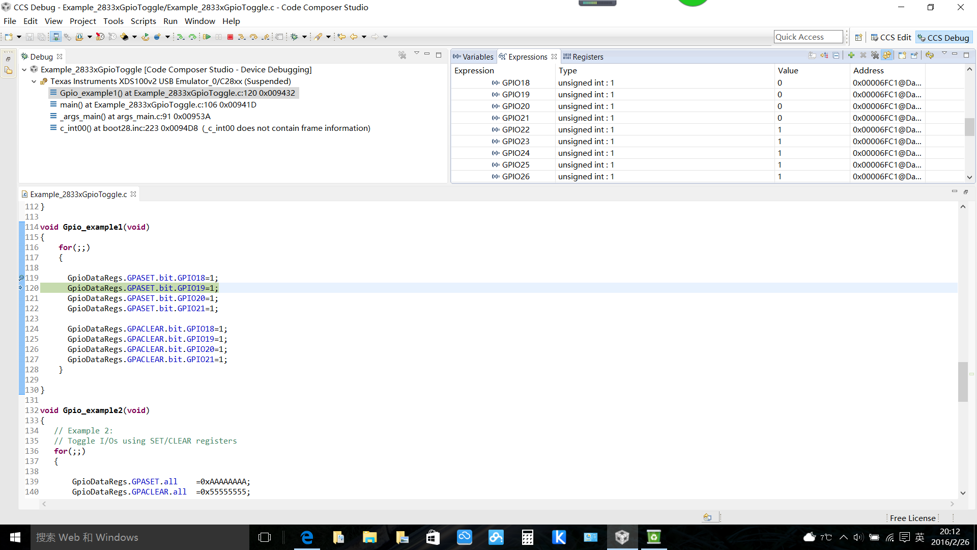

But when Run this code:
for(;;)
  GpioDataRegs.GPASET.bit.GPIO18=1;
  GpioDataRegs.GPASET.bit.GPIO19=1;
  GpioDataRegs.GPACLEAR.bit.GPIO20=1;
  GpioDataRegs.GPASET.bit.GPIO21=1;
  GpioDataRegs.GPACLEAR.bit.GPIO19=1;
  GpioDataRegs.GPASET.bit.GPIO20=1;
  GpioDataRegs.GPASET.bit.GPIO18=1 is not work,when run GpioDataRegs.GPASET.bit.GPIO19=1 ,the result is Gpio18 and gpio19 toggle together
why is this?
