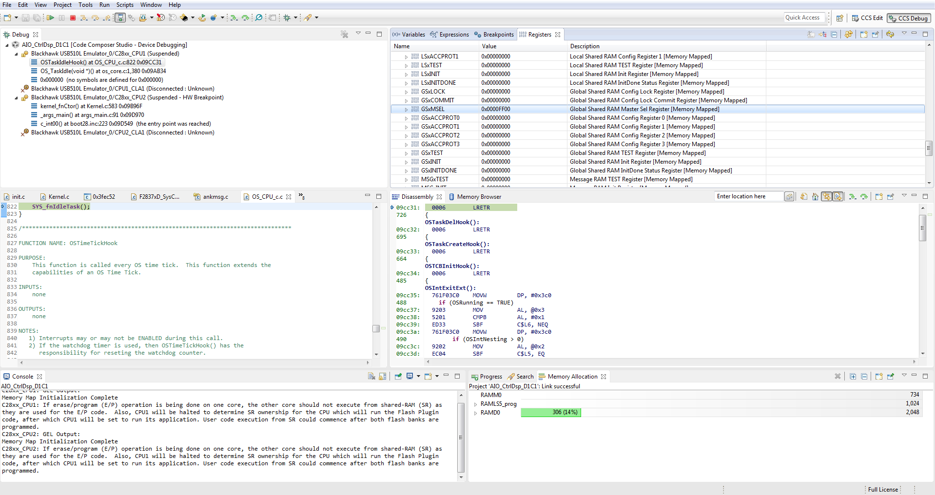

I have been facing an issue in my code and I have run out of ideas so far. I am wondering if I am missing a detail regarding the dual core structure of the TMX320F28377D. Control card R1.1.
I have two projects almost identical running on each CPU mostly it differs on the linker. CPU1 runs with no issues but on CPU2, on the first time I run the code, I get into an Illegal_ISR.
If I do a CPU Reset and Restart then the code run stable. I cannot understand or identify what changes from the first run to the second after the reset.
Here is a screenshot. The address 0x01701C is RAM assign to data so clearly the code is jumping to weird address.
If I debug step by step I can move forward in the code. But when I hit 'Play' then I get to the Illegal_ISR. Any idea is welcomed!
Matias

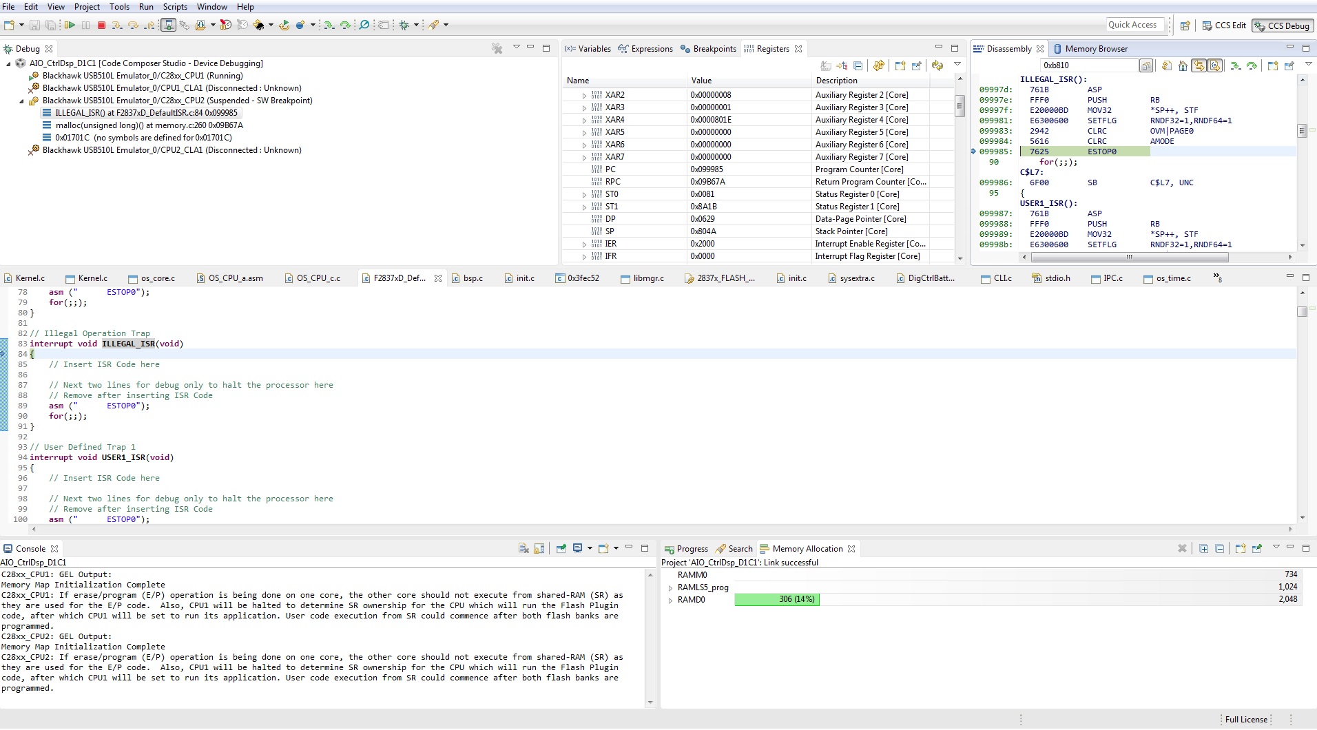

  • Matias,
    In this snapshot CPU2 is halted inside main which means it has already jumped into main. It'll be good to check the status of this just by running the CPU1 code (CPU2 is halted at reset vector). If you see the values correct in that case as well then you need to step through CPU2 code to see when it goes into Illegal_ISR.
    Vivek Singh

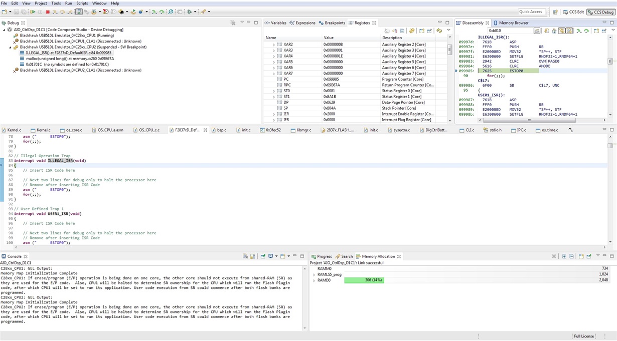

  • Ok. Can you step through the CPU2 code to know which part of the code is causing the Illegal_ISR and from which memory location that code is running.
    Vivek Singh
  • Hi Vivek, thanks for taking the time to follow up. At the beginning I thought the error was not consistent but it turns out it is.
    At a point in the code a malloc() is called. Upon returning it seems that a pointer is not recovered correctly to XAR7 and the code jumps to 0x00000.
    Interestingly, the code crushes the first time, but after a reset, the execution of the code is good. I am going through the assembly code to understand the problem. If you have any hint would help.
    Thanks a lot!

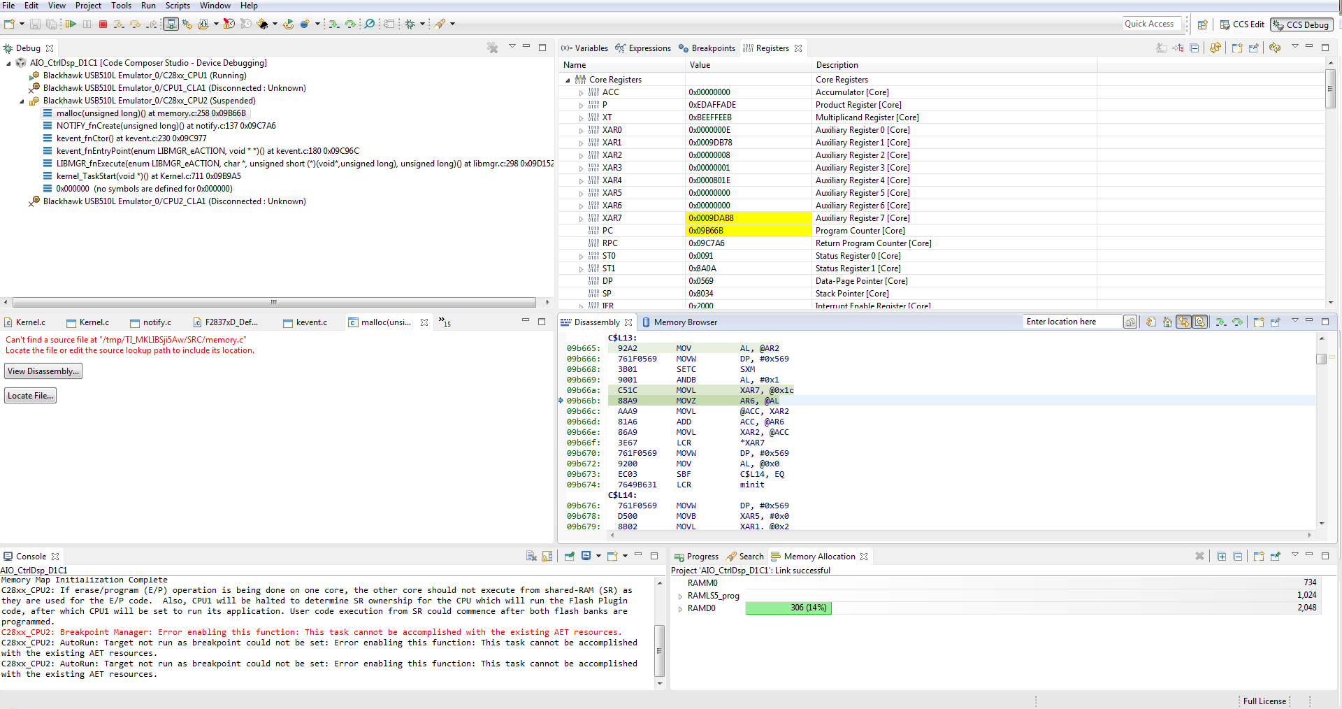

  • Hello Vivek and the rest of the community,
    If I may: I am still struggling with this problem. Basically, the following instruction is suppose to load a pointer on XAR7 but it is not doing on the first attempt after loading the code
    09a8f7:   C51C        MOVL         XAR7, @0x1c
    The fact is I do not know where is this pointing to, what kind of data it is...? Cannot find it in RAM.
    Thanks again,
    Matias
    Matias,
    Malloc returning 0x0 means it couldn't allocate memory from your heap , can you debug around this and see if the heap from where the malloc is trying to allocate is declared/initialized/allocated/assigned correctly?
    Also on the second point, code running from second time after reset tells that something is getting initialized after your code is loaded or run for the first time. Try loading the code, do a debug reset and restart and run, does it run? Does your code gets to main() or it goes to weeds before it reaches main()? If it doesn't run but only runs from second run onwards then you definitely have some memory being initialized as needed because of the first run.

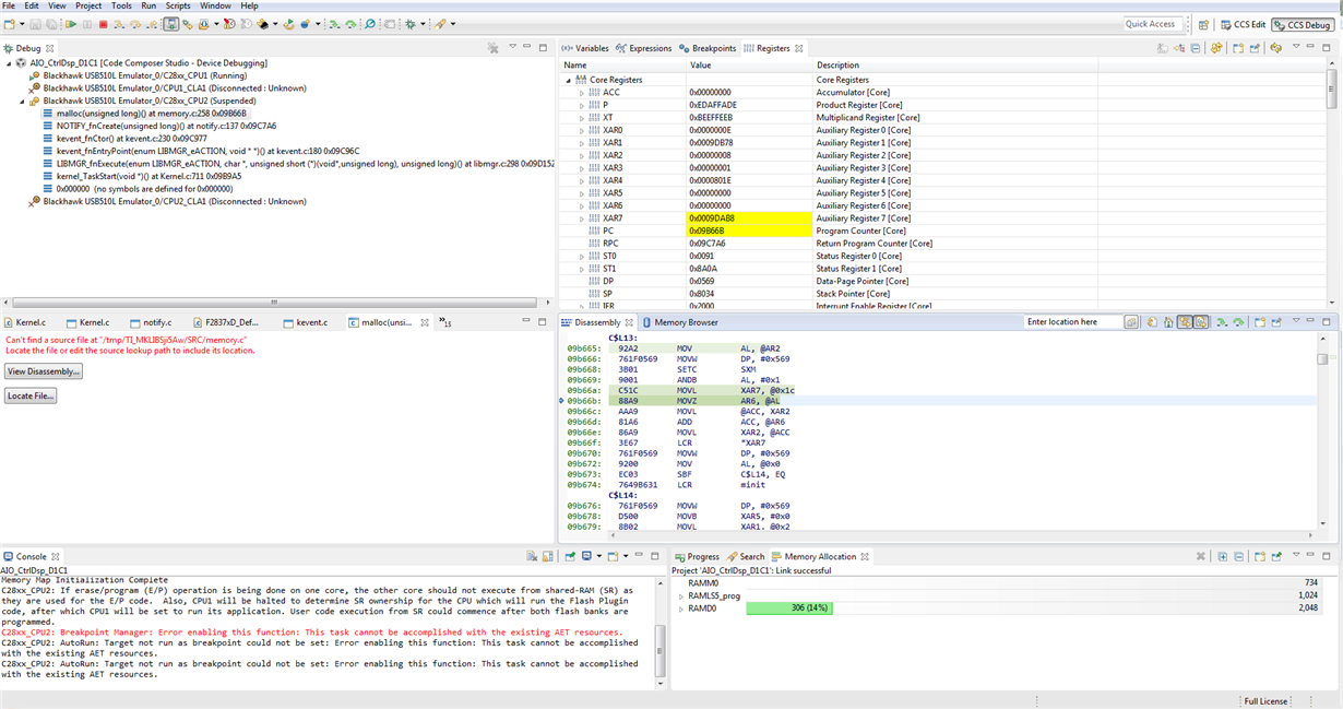

  • Dear Vivek and Santosh,
    Thanks for the time and all the input provided. Following Vivek's comment I have reviewed all registers in CPU2 and it turns out that there is a NMAVFLG for CPUWRITE in '1' and the NMCPUWRAVADDR is 0x000156A8.
    Here is my understanding of the situation. Hope you can follow me:
     - I load CPU1 for debugging.
     - Then I connect CPU2 and load the corresponding .out file. Part of CPU2 loads on GSRAM8 (.cio, .bss, .esysmem, .ebss). Since CPU1 has not started yet, CPU2 does not have permit to write there . I believe this is why when my code is loaded into CPU2 this flag is set and is causing the problem when starting the first time.
    If I run CPU1 and then reset and restart CPU2, then the flag is gone and the code runs with no issues.
