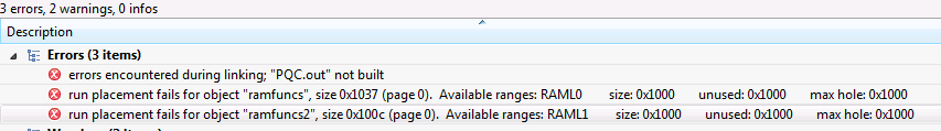

But I am getting followng error "run placement fails for object "ramfuncs""
My question is why this is coming and how to solve this?
If I add some random code I am not getting any error. But whenever I tried to call some function and try to take some decision from that function output I am getting this error.

    I m getting attached error

  • Amitabha,
    The error is telling you that the sections ramfuncs and ramfuncs2 will not fit in the available memory that you are trying to link them to.  ramfuncs is size 0x1037 words, but there is only 0x1000 words unused in RAML1.  Similar for ramfuncs2.
    You need to link the sections to a RAM block that can fit them.

  • Amitabha,
    You need to edit the linker .cmd file that you are using to place these sections.  You may have more than one .cmd file in your project.  For example, there may be one called DSP2833x_Headers_nonBIOS.cmd.  That one is for the peripheral header file structures, and is not the one you want.  You want the one that that specifies the RAM and FLASH, and then links the sections to these memories.
    Since you've moved some of your sections out of the ramfuncs/ramfuncs2 and obtained a successful build, look at the .map file created by the linker in examine the memory usage.  You can identify where you have free RAM in your system.  Then you can adjust the .cmd file to link ramfuncs and ramfuncs2 to larger available memory.
