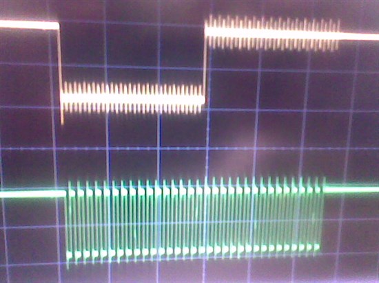

hi all,
im using the SPI of f2812, the problem is, i can see the Clock, but the data output, no,,,here in the picture you can the clock, but the data no,,,,
just peak at the start of the clock and ofcourse , and the ened of the clock, but nothing else,

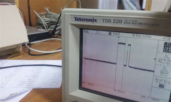

    actually i discovered where is the problem, but i dont know how to solve it,
    the initialization of the SPI,
        SpiaRegs.SPICCR.bit.SPICHAR = 0x7 ;   8-bit characters,,,,,, NOT WORKING
        SpiaRegs.SPICCR.bit.SPICHAR = 0xF ;   16-bit characters,,,,,, WORKING
    its like that    A= 0x1000;   //it sends 1 first
    its like that    A= 0x0001    // it sends 1 in the end,
    the problem, is in the second case, which is considered 8-bit, the output of SPI, is around 100mv, as the image i sent earlier,
    THE MAIN PROBLEM, the Slave part, is only 8-bit,,,,,,,so it always receive zeroes,,,,, :(
    i dont know what is the problem, soooo strange,

    the issue is, when i make the transmitted data 8-bit,,,,,, the output pin,,,, give me peaks like the first image,,,,,,,, so, no output at all
    and when i make the setting to 16-bit, the output is working fine,,,,,
    why i dont make it 16-bit,,,because the SPI-slave, is only 8-bit,
    Hasan

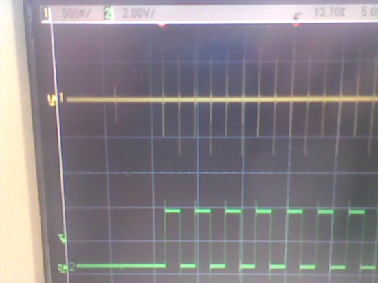

  • Try this:
    SpiaRegs.SPITXBUF = 0xFFFF;
  • for confirmation, you want me to send th 0xFFFF, write,
  • last image, after i sent 0xFFFF ,
    while its connect to the slave
  • In this case, is SPICHAR set to 0x7 (8-bits) or 0xF (16-bits)?  I see 16 clock cycles, but it looks like the data is 0x00FF.

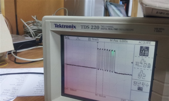

  • last one was when im putting the setting, at   0F  16-bit ,,,,,,,,it transmitt write, the 0xFFFF, but in the Lowest bits
    iwhy is that,,,,,, when it was 07, it transmit only the 0xFF, and when its 0F, it transmit 0xFFFF but in the lowest,,,,,
    Always transmit the Full as the half, and the Clock is double than the setting, and when its normal i mean when the clock is right, the no output data come out
    no idea,   does anyone faced that before :(

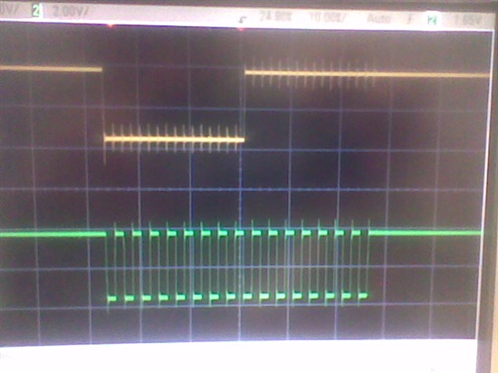

  • cio Tutti
    i think, the problem as follow,,,
    the when i have 8-bit clock, i got 16-bit output,,,,, i mean, the output when its rising edge and falling edge,,,,,,,NOT only with rising edge,,,,
