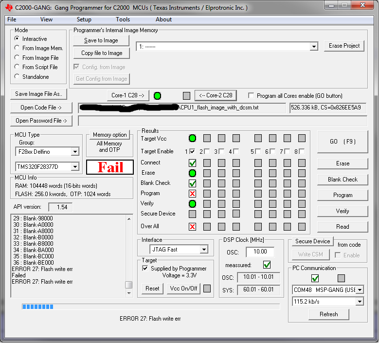

I'm having issues programming the DCSM values using a C2000-GANG programmer and TI-TXT format programming files.
The format of the file I used is below where the Xs are the CSM password. Is there something wrong with the format or am I unable to program the DCSM in this manner? I also read out the flash and it looks like it did program the first 0x20 words correctly then failed on the rest.
@78000
FFFF FFFF FFFF FFFF FFFF FFFF FFFF FFFF FFFF FFFF FFFF FFFF FFFF FFFF FFFF FFFF
0000 FFFF FFFF FFFF FFFF FFFF FFFF FFFF FFFF FFFF FFFF FFFF FFFF FFFF FFFF FFFF
FFFF FFFF FFFF FFFF 5555 1FFF 5555 1555 XXXX XXXX XXXX XXXX XXXX XXXX XXXX XXXX

  • Hi Mike,
    In this GUI at lower right corner there are additional option for "Secure Device". In this case since you are programming the DCSM value as part of the code, you may want to enable the option "from code". Please try this and see if that helps.

  • I think I already have it selected "from code" unless I'm missing something.

  • Hi Mike,
    Sorry for late reply.
    In the USER OTP section we have some reserved space and those should not be programmed. In the code file the reserved space should have blank space (specifically location 0x78018 to 0x7801B and 0x78218 to 0x7821B). Please update the code file accordingly and that should fix the issue.
    I am attaching a sample code file for your reference.
    BTW, how did you create your code image file?

  • Hi Vivek, thanks for following up on this I'll give it a shot within the next few days. I need to procure a board that hasn't had the OTP programmed yet.
    As far as creating the image goes I already had a binary image and just wrote a simple application to transform it into the TI-TXT format. Then manually added the extra OTP data. It's been awhile since I've looked at this, but I believe I had issues getting the TI tools to work. If there is an easier way to do this using TI tools that would be great. I have to combine an out file, a simple binary header for adding software revision and out metadata in the flash, and the OTP stuff.

  • I've got a fresh board and I'm looking at this right now.
    In your post you say that (0x78018 to 0x7801B) and (0x78218 to 0x7821B) are reserved and the example file you attached is actually not programming (0x78014 to 0x7801D) and has 0x78020 and 0x78021 defined twice? The same goes for (0x78214 to 0x7821D) and 0x78220 and 0x78221.
    Is there something I'm missing or was the file generated incorrectly?

  • Well it seems as the the file for reference is incorrect and I would like to make sure I understand you correctly. Also, it would probably make sense to clean this up as the forum is used as a sort of wiki for other users also.
    Does the example in ControlSUITE now output a TI-TXT format file?
    Also, in reply to the "single binary" generation you referenced earlier, I cannot simply use the example because I MUST include a custom header applied to the binary file after compilation.
  • Mike,
    Compiler generates .out file and from that one should be able to generate hex file. If you look at example code then you'll find that these asm file and linker cmd file can be included in your main project file itself so that the DCSM settings will be part of your main .out and you don't have to have additional header.
    But if you need to have the header file then please remove the reserved locations (refer device TRM for reserved location address) from the file. Reference TXT file I attached earlier was to show how to create different section.
