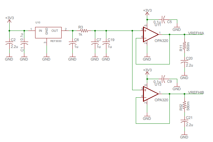

I am using lunchpad board with TMS320F28377s. I am initialising the ADCa and just connect it to the potentiometer, and rotate the potentiometer continuously, but the result registry is not continuously changing. it gets fixed values sometimes and it jumps to higher value suddenly. What is wrong here?
it is only changing continuously smaller than 440 and larger than 3896.
Another issue is the zero voltage, when the pin is connected to GND it reads 56. but if I increase the acquisition window (acqps to 100 DEC) it will solve this problem.
Another Problem, When I power the board with usb, why is the VREFHI 2.99v instead of 3.3v?
