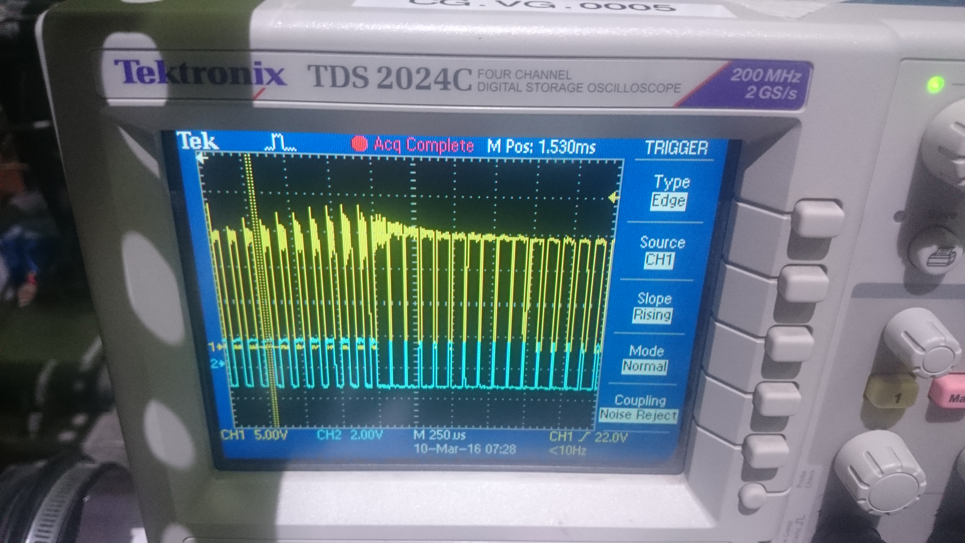

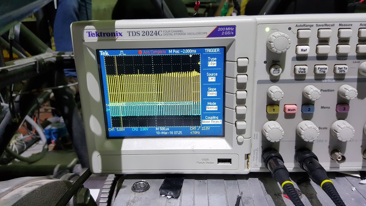

We have tested this inverter with 150Vbus and we saw something like this. When we started to rotate the motor, motor was running smoothly. There was no issue with that. But when we increased torque command (Iq_ref) after some torque level, motor sporadically makes a skipping noise. During the noise we see the wave forms below, where the DC bus voltage seems to oscillate. We have a 800uF DC link capacitor as well as sunbber capacitors on the IGBT legs.

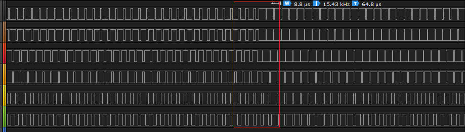

During the DC bus oscillations,we notice that the PWM signal duty cycles  from the c2000 seem to stay static, and after the skipping noise it gets back to normal. And this continues sporadically, increasing the events with higher Torque Commands.
PWM output data from micro controller at fault time
Collector- Emitter waveform of a IGBT in inverter at fault time
