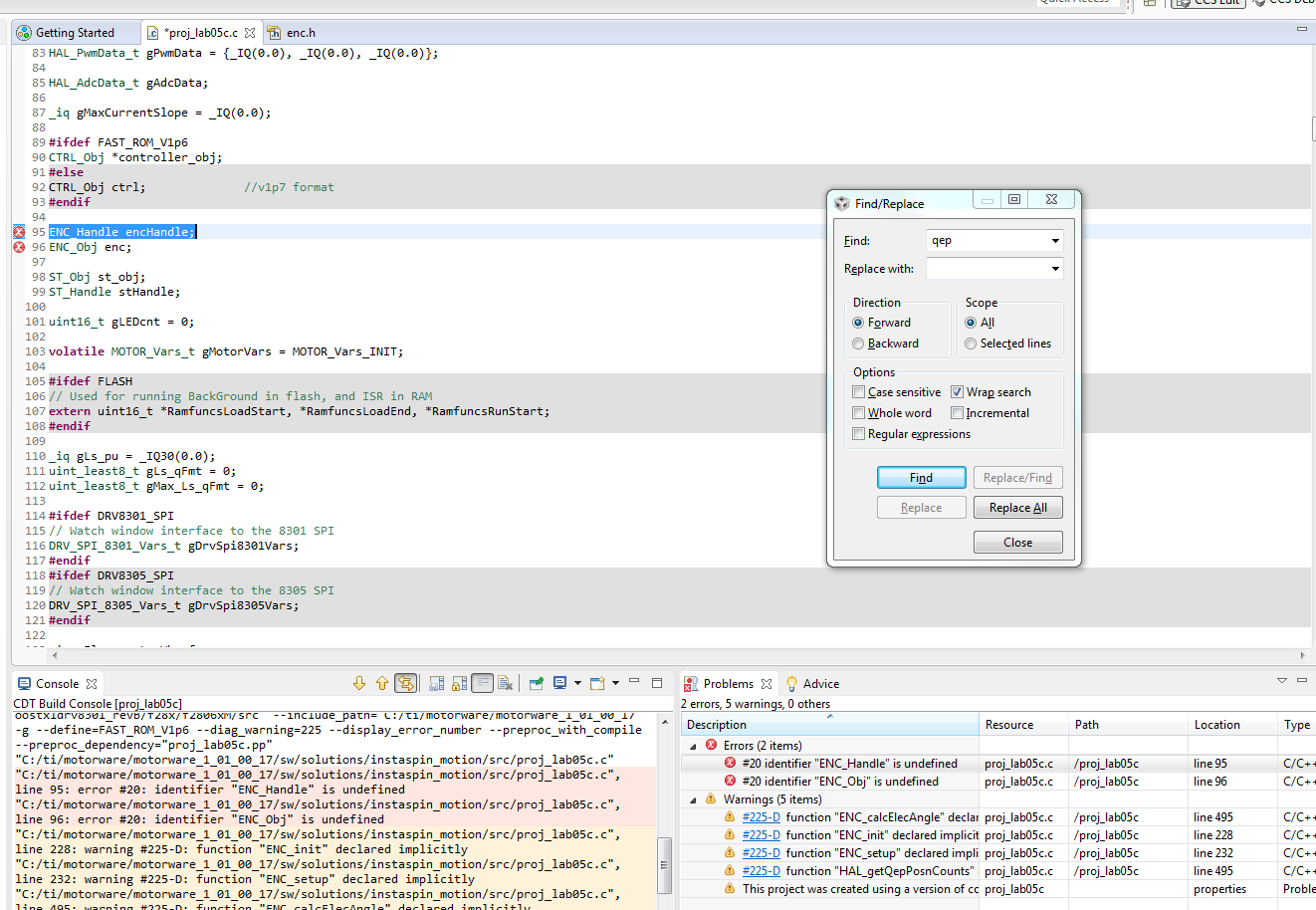

However, when I run motor in debug mode, I always see the value of gMotorVars.Speed_krpm = ZERO???
I think it maybe I have not know how to use two modules to get the right result, although I checked the A, B and Z signals on my hardware and the result is good.
Could you please guide me to resolve this problem.

  • Dear all,
    I fixed the error which relates to reading speed of motor using ENC module. The problem is in setting the parameter for ENC_setup().
    According to Motorware's example:
    //!> initialize and setup the Encoder modude - Added by Duongtb (24-Mar-2016)
            // initialize the ENC module
        encHandle = ENC_init(&enc, sizeof(enc));
        // setup the ENC module
        ENC_setup(encHandle,
                1,
                USER_MOTOR_NUM_POLE_PAIRS,
                USER_MOTOR_ENCODER_LINES,
                0,
                USER_IQ_FULL_SCALE_FREQ_Hz,
                USER_ISR_FREQ_Hz,
                8000.0);
    But due to setting sample_period = 1 as above, an unstable result of speed will be received. If we setup the true value for this parameter, we will get the stable result of speed.

    I am using the LaunchPadXL TMS320F28069M and the projects in motorware  for the boostxldrv8301_revB.
    I am trying to get some experience on how to include and get running the encoder module in a new project (enc.c, enc.h, qep.c, qep.h). To do so I started comparing proj_lab12a and proj_lab5c, and add the encoder module in the latter, but with some difficulties...
    1) Somewhere in proj_lab12a "QEP" is defined which enables all the good settings for the encoder module in the relative hal.c. where is this definition? I want to do the same for proj_lab5c, but I cannot find it anywhere I have looked so far.
    2) Even if I get rid of all the controls relative to the definition of QEP (basically following step by step the original "How to use ENC + QEP modules to measure motor speed by an Incremental Encoder?" post and the step by step instruction of the instaspin user manual section 18 sensored system) I am failing to compile because the ENC_Handle and ENC_Obj look to be undefined.
    Any advice?
    Thanks in advance
    Lorenzo
    It is defined in the project settings under Project Properties -> Build -> C2000 Compiler -> Advanced Options -> Predefined Symbols.
    I'm assuming you are missing the include for the enc.h header file.
  • Hello Adam,
    thank you very much for your reply.
    Yes, I was missing the enc.h header file in ctrl.h.
    lorenzo
