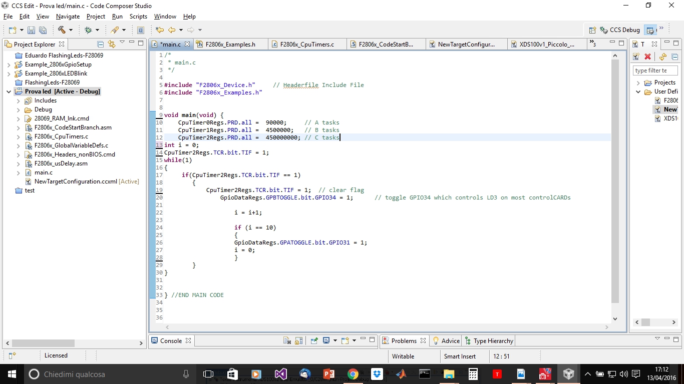

Hi :)
i'm beginner.
I had read the manuals
and now I'm trying to change with the programs.
I want to try to change the main for "flashing LED".
this is my code:
#include "FlashingLeds-Settings.h"
#include "PeripheralHeaderIncludes.h"
int i;
void main(void)
// INITIALIZATION - General
//-------------------------------- FRAMEWORK --------------------------------------
CpuTimer0Regs.PRD.all =  mSec1; // A tasks
CpuTimer1Regs.PRD.all =  mSec50; // B tasks
CpuTimer2Regs.PRD.all =  mSec500; // C tasks
i = 0;
CpuTimer2Regs.TCR.bit.TIF = 1;
while(1)
if(CpuTimer2Regs.TCR.bit.TIF == 1)
CpuTimer2Regs.TCR.bit.TIF = 1; // clear flag
GpioDataRegs.GPBTOGGLE.bit.GPIO34 = 1; // toggle GPIO34 which controls LD3 on most controlCARDs
i = i+1;
if (i == 10)
GpioDataRegs.GPATOGGLE.bit.GPIO31 = 1;
i = 0;
} //END MAIN CODE
 i dont understand the error :(

  • the structure of my program "prova led" :
  • A few questions to help clarify.
    1) I see you included F2806x_CpuTimers.c in your project folder called Prova led. In addition you also have your main.c file. This could be the case of where you have two main() functions in the same project folder which could cause issues when trying to compile and debug. So do both .c files have a main() function.
    2) I can also see that you created a new .ccxml target configuration file. Could you show me a picture of what your configuration looks like? If you reused an example project, this new target configuration file may not be necessary, but I would be ok with taking a look at it anyway.
    3) From a programming standpoint, it looks like you are trying to toggle GPIO34 a total of 10 times. If that's the case, you may want to consider using a for loop to increment. On the other hand, you could implement the toggle as part of an ISR in which case you could move the toggle logic to the ISR function call.
    Let me know what you decide to do and please let me know if you have any additional questions.
    Kyle

  • 2)  my ccxml configuration f
  • 3) yes, i want to toggle GPIO34 and then toogle GPIO31. I used a while (1) loop. it's the same of for (;;) loop i think. it's correct?
  • Yes, it is certainly ok to have more than one .c file. However, the issue arises if there is more than one main() function across all the .c files included in a single project folder. You may want to double check to make sure only more main() function exists.
  • In your target configuration file, you should probably switch to using XDS100v2 probe. That is the preferred debug probe to use.
  • And in response to your coding question, yes the for( ; ; ) and while(1) statements are essentially the same. Both create infinite loops.

  • if(CpuTimer2Regs.TCR.bit.TIF == 1)
    setting to 1 clears it? I am not checked the data sheet but generally 0 clears.
  • thanks for you suggestion. but it's no problem i think :)
    so... i changed my programm and now the error is:
    ""C:/ti/controlSUITE/device_support/f2806x/v151/F2806x_headers/include/F2806x_Device.h", line 79: error #41: expected an identifier"
    at 79 line, i have this code:
    "extern __cregister volatile unsigned int IFR; "
