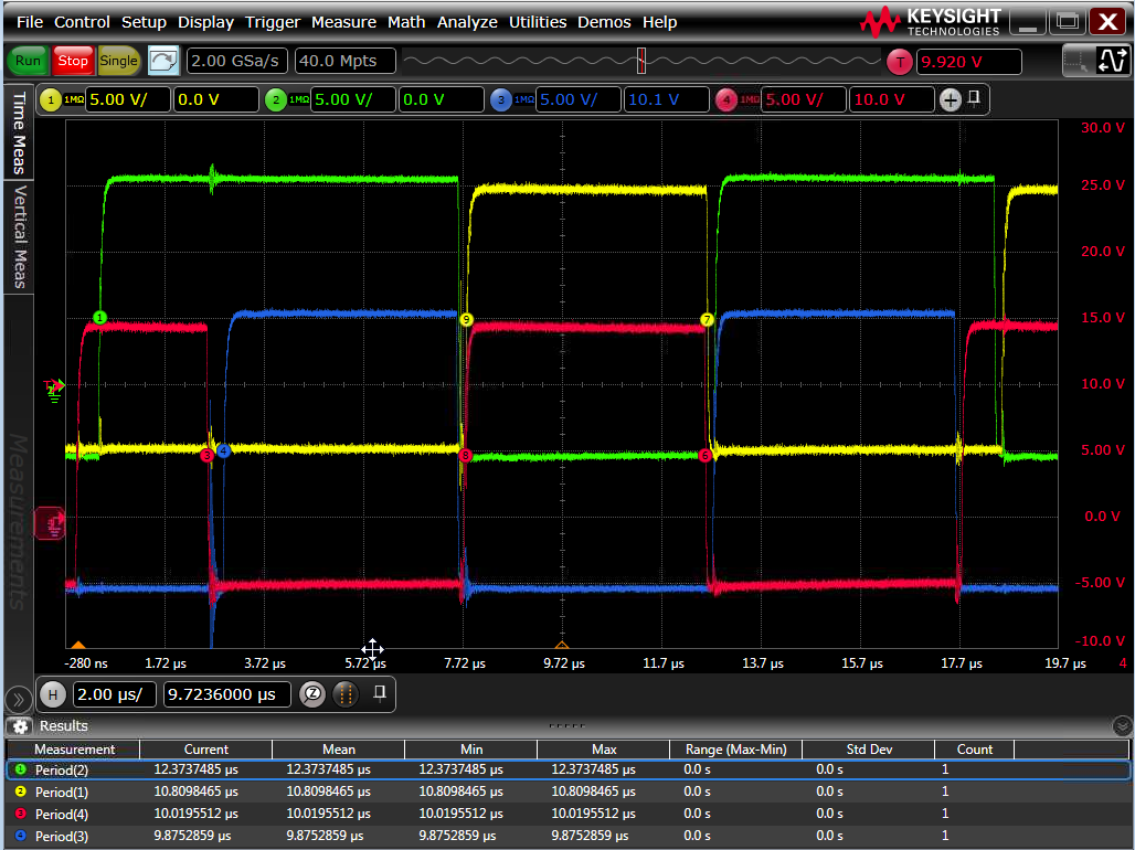

Hi all,
I have been working on getting a closed loop phase shift converter up and running and I am 95% of the way to having things working.  Unfortunately I'm seeing some glitches that are causing big problems.  Essentially what I'm trying to do is have a slow start algorithm run while I monitor the output voltage of my converter.  That process works, however when I switch over from the soft start routine to the normal phase shift operation I get glitches on the "slave" phase shifted ePWM modules.  The problem I am seeing is that the period on those particular channels is too long for several switching cycles. I am not using the stock PSFB code; I actually ended up putting in a phase offset in the ePWM1A/B channels and inverting the ePWM2A/B channels to get the proper phase shift I was looking for.  I'm not sure if this might be a source of the issue I am seeing.  As can be seen below the ePWM1A/B signals (red and blue) have the proper period as soon as the ePWM modules turn on.  The ePWM2A/B signals (yellow and green) however have much longer periods than programmed.  To avoid glitches I even turned the ePWM modules into input GPIO pins temporarily and only turn them back to ePWM modules as the last step of setup.  Provided below are the start up routine and the code for the PSFB setup, as well as a scope capture.  I'm running out of ideas and don't have a solid idea of what the source of the problem might be.  Any help would be appreciated. - Lance

    I managed to clean things up a bit by tweaking some parameters in the trip zone module.  It fixed the really long, unmatched pulse on start up, but the first few clock cycles still give strange results.  I think that might be related to the 2p2z controller block saturating.  I might look into change the constraints on the saturation levels to try and mitigate the issue.
  • Hi Lance,
    I suggest following this order when initializing the ePWM clocks:
    1) Enable ePWM module clocks in the PCLKCRx register
    2) Set TBCLKSYNC=0
    3) Initialize peripheral registers/configure ePWM modes & prescaler.
    4) Set TBCLKSYNC=1
    Right now, it appears your code is implementing step 4 before step 3 and it's unclear if step 2 was completed.
    You can find more details in the ePWM Module Reference Guide, Section 2.2.3.2 found at www.ti.com/.../spruge9e.pdf
    Elizabeth
  • Thanks for the help. I got everything fixed and working nicely. It turns out that a large source of my problems came from the fact that the 2P2Z block I was using had integration action and it was saturating which was causing the long initial pulse. After putting in a slew limit loop I got my converter running closed loop.
