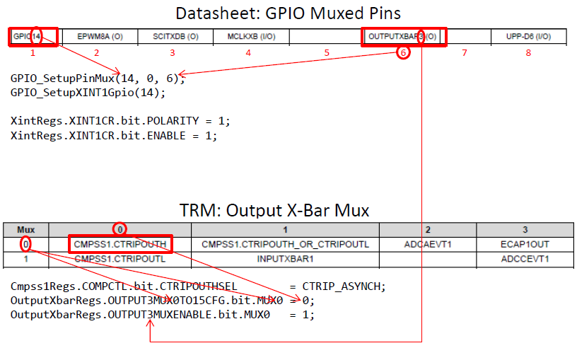

  • Nick,
    Here's a copy of "cmpss_asynch" with some code snippets ported over from "external_interrupt" to enable GPIO interrupts using the comparator output pin.

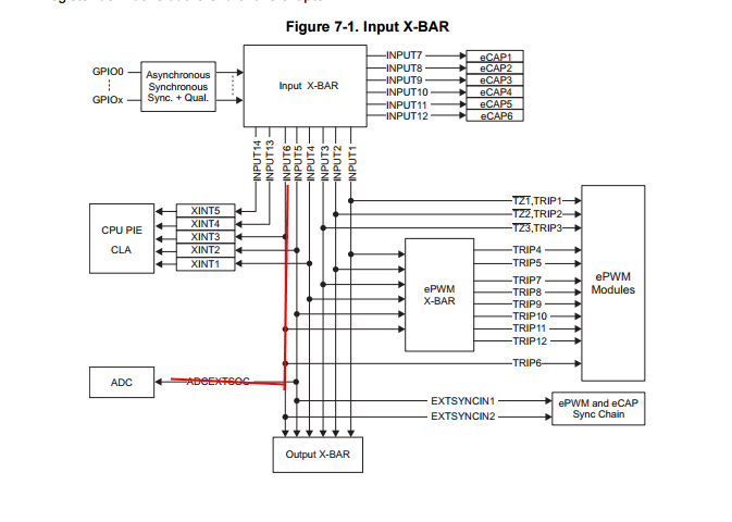

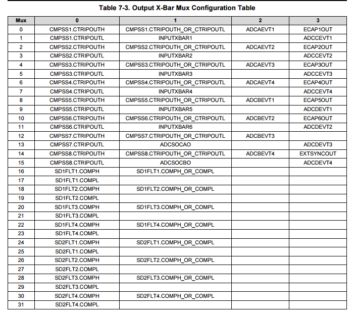

  • Hi Nick,
    To get the CMPSS outputs to a pin, use the output x-bar.  For a give output x-bar, you just need to make the following selection:
    Once you have made the selection for a given output XBAR, you can get it to the pin by changing the GPIO mux for a pin that has that output XBAR:
    Now you should be able to observe it on the pin.  To trigger the ADC, there is a singe input XBAR that you can configure:
    This configuration is as easy as picking whatever GPIO you want:
    In the ADC SOC configuration logic, you would write '4' to the trigger select to use this as the trigger.
    Note that the output XBARs have a big OR gate in them, so you could use multiple CMPSS modules to cause the same ADC trigger, but you can't get multiple CMPSS modules to generate different ADC triggers.
    Now if you want to generate an interrupt instead of triggering the ADC, use input Xbars 14, 13, 6, 5, or 4.
  • Regarding the 100 pin TMS320F28377S package and the OUTPUT XBAR. It was interesting to note that even though some GPIOs were not available external to the chip, I still managed to map these pins internally via the GPIO mux to interrupts coming from the CMPSS comparator outputs - that is encouraging.....
    However this is just playing with the first instance of the comparator structure elements as provided in the above mentioned examples. I tried to cut 'n paste, twiddle settings but were unable to duplicate the comparator example for cmpss(1) onto additional comparators -
    However I am able to map the first comparator to any of the OUTPUT XBAR and generate interrupts - that part I seems to have figured out.

    Here's a breakdown of the key configurations.  Hopefully it helps.
    -Tommy

    InitCMPSS1(); // route XBAR 7 to GPIO 16 on ADC_A2: CMPIN1P
    InitCMPSS2(); // route XBAR 3 to GPIO 14 on ADC_A4: CMPIN2P
    InitCMPSS3(); // route XBAR 1 to GPIO   2 on ADC_B2: CMPIN3P
    InitCMPSS4(); // route XBAR 4 to GPIO 15 on ADC_14: CMPIN4P
    GPIO_SetupPinMux(16,0,3);// XBAR 7  to ADC_A2
    GPIO_SetupPinMux(14,0,6);// XBAR 3 to ADC_A4
    GPIO_SetupPinMux(2,0,5);  // XBAR 1 to ADC_B2
    GPIO_SetupPinMux(15,0,6);// XBAR 4 to ADC_14

    OutputXbarRegs.OUTPUT7MUX0TO15CFG.bit.MUX0 = 0;
    //Enable OUTPUTXBAR3 Mux for Output
    OutputXbarRegs.OUTPUT7MUXENABLE.bit.MUX0 = 1;
